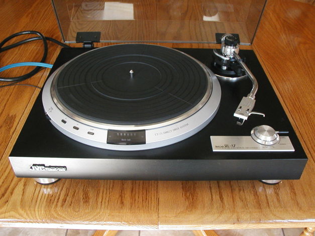

So why my interest in JVC? Well at the last local AK gathering at Marks (Aerobat) house I picked up a QL-A7 turntable from Keith (kcdonahue). It's a stunning looking table and rather hefty. Build quality is up there with the best of them but I wasn't prepared for how good it sounds.
I did a lot of reading about the higher end JVC tables and am impressed with the engineering and innovation that came from that company, also known as Victor. They designed cartridges, tonearms and motor drive units for broadcast use, the most demanding market ever.
Over here in the US the most common of the high end turntables are the QL-7 (fully manual) and the QL-A7 (semi automatic) although they did sell the QL-8 here as well. I don't think the QL-10 ever made it outside of Japan and Europe.
The QL-71, QL-81 and QL-101 motor drives are highly prized and fetch very good money. Ql-71, QL-81 and QL-101 are the bare motor drives from the respective models. Like a Denon with it's flying saucer shape the motor drives lend themselves to being re-plinthed into custom created plinths, sometimes with two tonearms.
JVC also made some other model QL turntables that were excellent in there own right. The QL-Y55F and QL-Y66F are full featured turntables with servo electric type tonearms fitted.
There are other QL models that enjoy a well deserved reputation as well.
JVC doesn't seem to get much love on most forums except for the lucky ones that already have them.
I figured lets start a thread were we can show off our QL turntables and mods.
Here is a pic of the model that I currently use, a QL-A7. I am using a Denon DL-103 cart into a Denon AU-320 SUT going into my Audio Research SP8 preamp.
It's an internet pic, my TT shelf is much to cluttered at the moment but mine looks just as nice.
