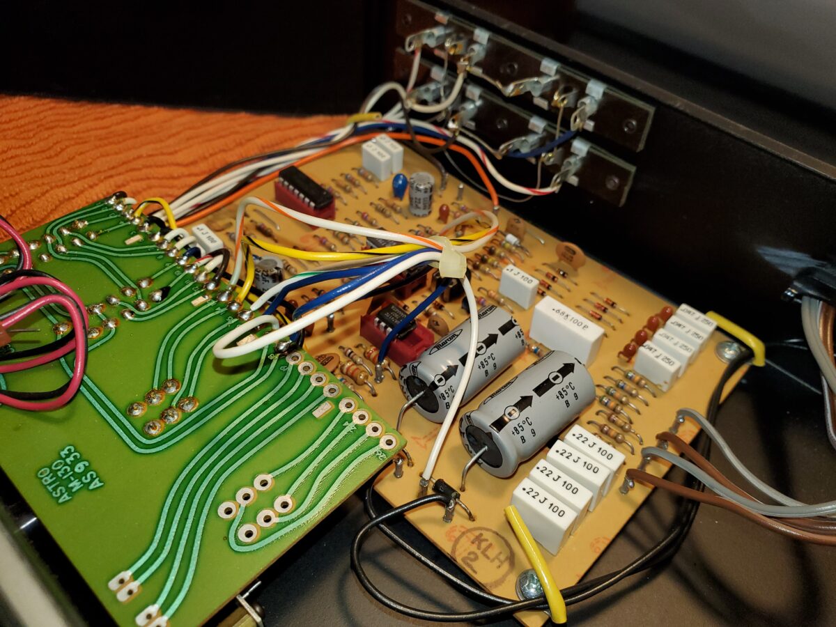

I've just read this thread and am feeling there may be hope for my beloved KLH-3s. I bought these second hand (I think an open box deal but can't remember exactly where or when), but I know I had them at least as early as 1983. I've carried these all over the world (ex-Navy) since.
I had them in storage for quite a while, and when I retrieved them, my heart sank. One woofer is cracking and doesn't work, the foam surrounding the tweeters is turned to dust, and I can't find the wall wart for the ABC.
I've been trying to find a parts list or breakdown, or even a shop that can restore them to their original magnificence (not really joking here!). I absolutely love these speakers and it might actually kill me (joking here) to put them in a recycle bin or sell them for parts.

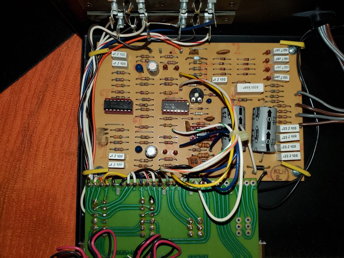

PPS: just opened up the ABC and am amazed at how clean everything looks after all these years. I'm no expert, but the caps all look great to me.

Will this plan work for a KLH-3 Analog Bass Computer (ABC) wall wart?
From everything I've read the ABC requires 13 - 14 VAC, 220ma, it draws 9 watts, and is an ac to ac adapter. I think the adapter below is correct, and I can just replace the connector with the one listed, or similar.
