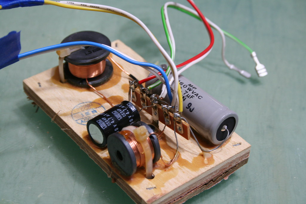

Crossover on separate panel with stand-offs that was stapled to the rear wall. I might clean this up a bit, but it is point-to-point wiring and the tweeter has a paper in wax cap. Replacement caps are Audyn Q4.

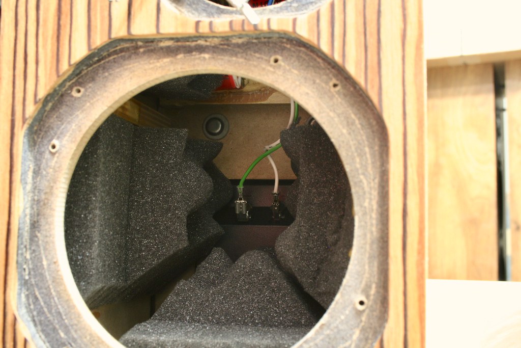

Dampening will go in once the bracing is done and the crossovers are reinstalled. Will be acoustic foam on the sides and light fiberglass stuffing.

Since the inside front bracing didn't stick to the melamine using wood glue, I used contact cement and that did the trick. There's now bracing on the fronts and on both long sides, it made a tremendous difference to how dampened these cabs are:
Added acoustic foam as dampening on top, bottom, and both sides:
