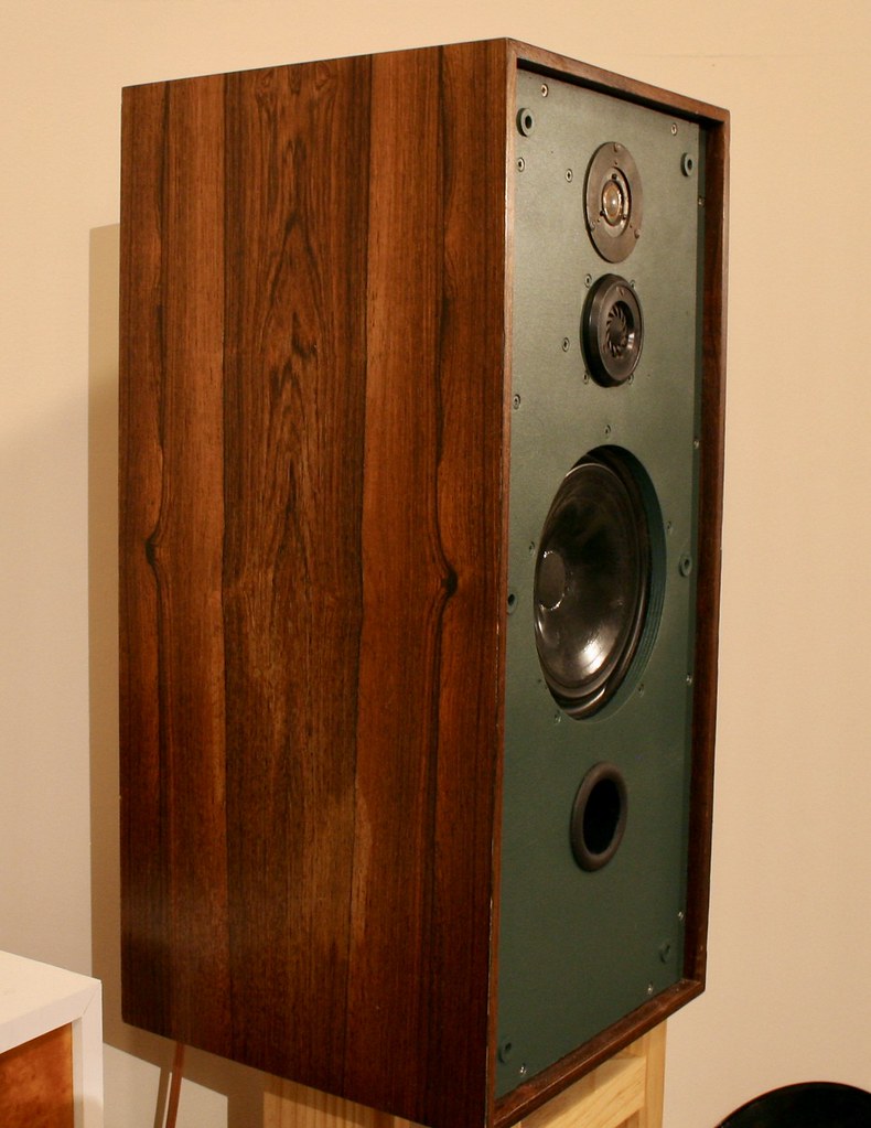

Drivers: Woofers are solid, no cracking at all around the cone-to-surround area as is allegedly common with these Bextrene woofers. Celestion tweeters will get flush mounted as per Troels Gravesen's testing / measuring that resulted in a notable improvement. The Coles super tweeters just need a little paint touch up.
I'm open to veneer suggestions. I've got walnut, teak, golden teak, mahogany, cherry, zebrano and rosewood on hand. I'm leaning towards teak or rosewood or walnut. Possibly with an olive green front baffle?

Wow, they really do look great in the pics. Where are the flaws?
There's several smaller damages, some discoloration, a tiny area that's lifting, and a small piece of veneer ripped off one of the bottoms. As is they're a 4 / 10 cosmetically.
I'm gonna make a serious effort to restore the original rosewood veneer, if I can't get it to be at least a 7 or 8 out of 10, I will have to strip all of the old veneer off (yikes) and reveneer in rosewood. Many labors, much expensive.

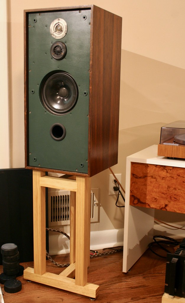

The stands they're on are too high, so I may play with flipping the speakers upside down until I build proper 12 - 15" high stands for these.

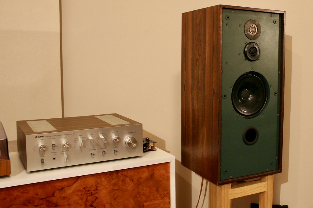

Little bit of an update: AKer @sp58 suggested the front and rear baffles can be flipped easily on the BC1 to eliminate the diffraction associated with a recessed front baffle. It seemed like an easy, free thing to try. I wanted to paint the front baffles anyway, so I did it to one of the speakers for starters (then ran out of daylight).
Red alnico woofers:
Not exactly the olive green I was looking for, but very close.

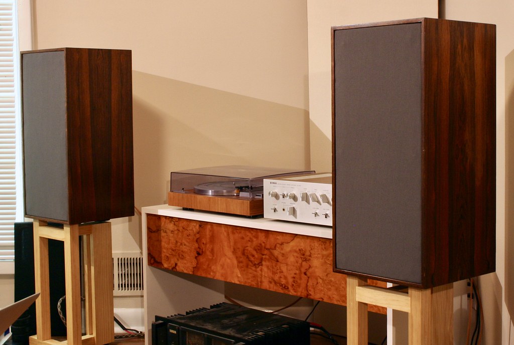

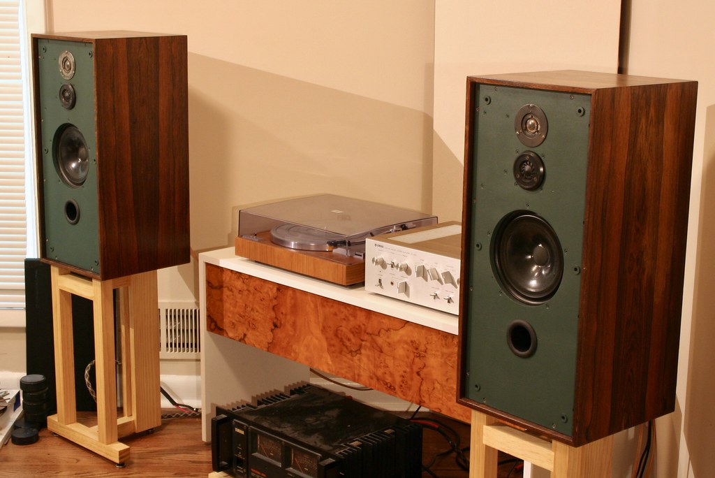

A final update and round of pics for the Spendors. The grilles are reupholstered, both baffles painted. The veneer is still original and I don't plan on messing with it anymore, as they are quite nice from a couple feet away.
They do best with the open style stands, even though they're still a couple inches too tall to be 'ideal' for the BC1s.
I've played them on a number of amps with different sources and logged many hours of enjoyable listening.
While they are great speakers, I am selling them on (locally only). An upcoming move is making me drastically down size and I think I'll be keeping only the Tannoys.
Are the fronts green? The wood looks sort of military green. It's a different look.
The veneer looks killer.
Are you downsizing to a smaller house? Hope everything goes well!
Thanks! Yes the fronts are olive green.
