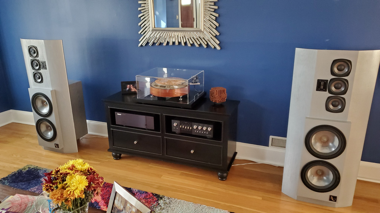

Rs ll with car subs...added banana posts and disconnected woofers from infinity xover do i can bi-amp..external dbx active xover to feed woofers run in series
Why in series...? They are supposed to be doing their own thing....each has its own sealed cab, and their own crossover point...

Because im not trying to triamp the speakers..the cut off for 1 sub is 60 hz..the other 125..not alot of stereo seperation detectable down there to my ears.. so I wired them like the kappa 9,rs3,rs4,etc..(2) 4 ohm woofs in series.i then cross them over with an electronic dbx crossover at 125...where the top woof extended to..i can actually go as high as 400hz if i wanted to(but want to use the infinity crossover point for the sake of the mids) ,which is the range of the improved woofers..which also are ideal for that enclosure volume as well ..i can adjust level,phase,crossover this way..as well as biamp the speakers
On aesthetics I’d say paint the baffle...not a fan of the brown front....
Thanks, started out as empty, beat up cabs, and corroded crossovers...took about a year to put together...a la cart is expensive so had to be patient and find best deals I could on components...
Those are absolutely gorgeous..well worth it..those aren't infinity mids are they? How do they sound?
they are right mids, when millersound checked them out for me he fitted them with bigger dust caps, stops them from bottoming out
Interesting, did he explain how a larger dust cap stops them from bottoming out? I'm trying to figure out how a different dust cap would do that unless it somehow changes the shape of the cone and lifts the v.c further up out of the gap.
