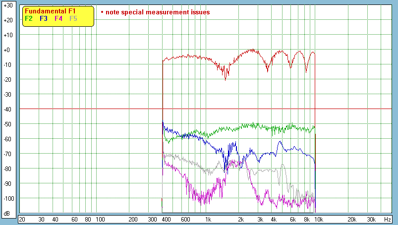

-30dB down for 2nd order distortion is considerably higher than the -40 to -45dB down that the typical "good" dome tweeter exhibits.
:nono: :nono:
What I already said a good dome has a SPL of about 90dB.
The HF driver above has 0,1% at 112dB!
When that dome tweeter reproduces 112dB it will have distortion levels above 2%. So they will distort about 20 times more. :wave:
You have to compare on the same SPL level :yes:
I don't agree with you, at all. It should be compared at referenced sensitivity because no one in their right mind would try to use a dome tweeter at 110dB and expect good results. If you are going to try to make that argument, you'd have to compare distortion of the compression driver/horn system at 90dB.
I do not have problems with that. The fact that good horn drivers have very low distortion stays the same.:thmbsp:
See the graphic of the eminence HF driver. Distortion measured <0,3% at 85dB 1mtr. It is not the best but all ready very nice
Let's put it another way. At their designed/intended playback levels, dome tweeters will tend to have *significantly* lower distortion than a similar quality compression driver.
I'm a big compression driver/waveguide fan, so please don't take it that I'm slamming the technology.
btw, .3% should be roughly what, -50dB? That's not out of range of what a great dome tweeter can do. Add 5dB to that eminence and we are talking very similar levels.
Show me a measurement of those dome tweeters. The eminence has around 2% THD at 100dB.
The compression driver above 0,1% 112dB way enough for high quality replay, is that so hard to understand, at 90 dB it will do easy -40dB THD.
Again SPL, THD at a level no dome can compete with.
To calculate distortion. say -30dB
((-30/10) inverse log)100% = (-3 inv log)100% = 0,1%
A dome tweeter of 90dB/ 1Wmtr at 100W will do 110dB.
50 dB is five orders of magnitude (or decades or "logs" if you prefer). 1% (1 part in 100 or 0.01 or two orders of magnitude) is 20 dB down; 0.1% is 30 dB down; 0.01% 40 dB; 0.001% is 50 dB.

A good performing dome. 0,1 % at 90 dB. Hobby hifi calls it extreme low distrosion. The compression driver above has 0,1% at 112dB.
Helmuth, check the new peerless HDS dome tweeter, it approaches -50dB for 2nd order HD across most of it's usable range, drops to mid-low 40s at the very top end.
I am still a firm believer that you should be comparing distortion at referenced sensitivities, not trying to compare drivers intended for completely different applications.

The selenium driver wasn't a good example I found a better one. Other wise music lovers will be misled.
Let's not have music lovers be misled by the compressed 20 dB/div vertical scale.
You'll give up the same 7.5 dB flattening that one to 30° horizontal for uniform power response out to there. It's clearly not a 90° horn, either, and has already lost it at 10° in the vertical.... :thumbsdn:
See below...
Yup, so your .3% would be -25dB.
Here's a dome (Scanspeak 9500) that's down at least 40dB (or .01%):
that grafic shows at 1k5 about -31 dB 0,08% second harmonic. 3k5 ,5k,8k2 also but it is good one indeed. so not -50dB
What I want to repeat is a horn driver can do better and certainly at high level.
And I want to say that because always every one mention distortion of a horn that isn't right.
