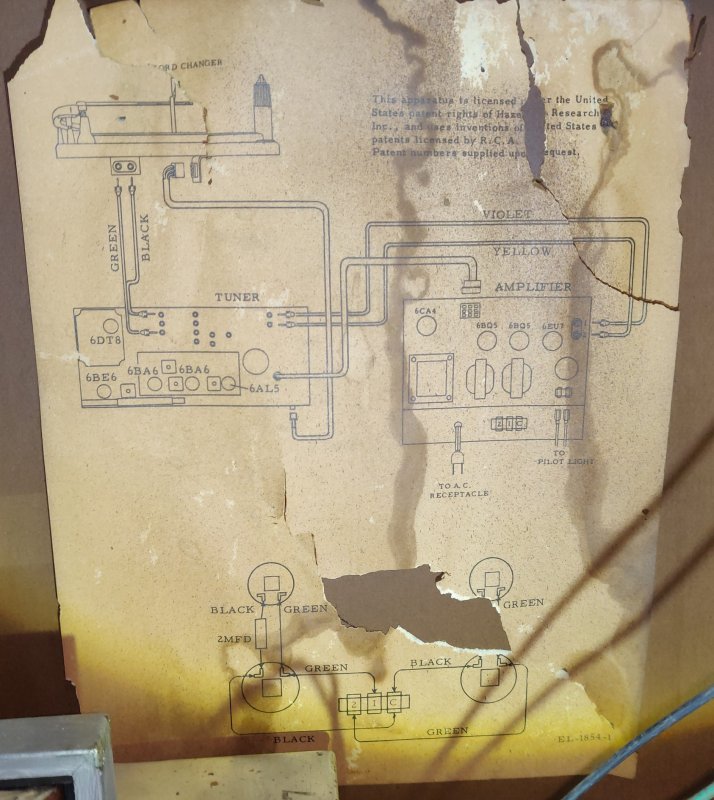

But while I was looking in my Maggie I found something interesting to me... This wiring flow chart has a patent license from RCA on it...
I thought they magnavox were the original designers apparently Magnavox was a OEM manufacturer in this instance...

Umm the piece of paper above the model number "the wiring flow chart" is it possible for you to get a readable picture of it posted please...

the “wiring flow chart” really just shows how the components are connected to each other..speakers multiplex, amps, etc. It doesn’t show anything particular about the components or capacitors. I have been able to find film capacitors which I believe are called orange drops with matching MFD and V but from what little I understand about these, they aren’t polarized.
