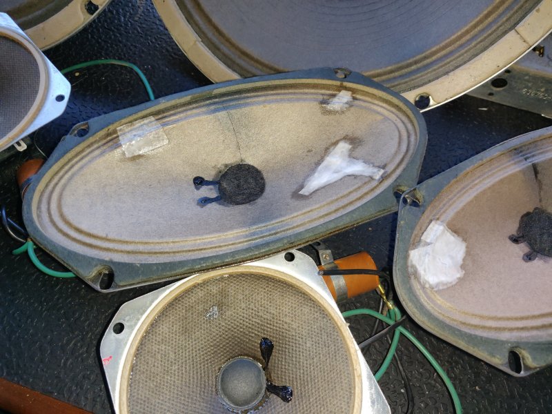

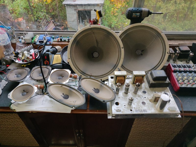

Recently I bought this magnavox console pull on Ebay. I was looking for the 12" speakers and ended up buying the group because I recognized the amps 9304 model number from one of Dave's awesome thread's here... $75 plus shipping for all... Yay
The speaker coils test good but the two midrange speakers cones have rips... From shipping...
I ordered some Aileen's tacky glue... To try repairing the cone's from the back... It's in the mail...

My original plan was to just buy the 12" woofer's and put a couple of modern efficient midrange speaker's tweeters and with them... on a standard three way crossover... but I don't know...
Any suggestions for the speakers I even have the original crossover cap and resistors...

You won't get much in the way of low bass out of those woofers. Maybe an open back box, or bass reflex design? I have a pair of 15" woofers and horns out of an old Magnavox 9303 amp console. I was thinking of building some open baffle speakers with them.
Flex Seal (no affiliation) rubber spray works excellent. I have a 15 inch leslie speaker which had a tear from the outer ring all the way to the dust cap. Flex Seal worked perfectly.

I was thinking about open back... The original magnavox tube consoles I've seen were mostly open or loosely closed... My magnavox astrosonic is open bottom I like it's sound...
Hmm weak bass isn't that partially the Amplifiers design limitations? I've read that increasing the coupling caps value helps with that on the magnavox console amp modules...
But I hadn't noticed it being weak myself...
I play acoustic guitar through mine and I have to turn the bass down on my mixer pre-amp channel or it gets boomy...
I boost the bass a hair on the pre-amp channel I used for regular music listening though...
Nothing wrong with the amp. Changing the coupling caps did add some to the bottom end though.
Hmm I have to think about that... Flex seal spray... Wouldn't it dampen the speaker cone some???
It was never an issue with my speaker. When it dries, it all dries. You could try the other FlexSeal products like the glue or other types where you can apply small amounts with a small brush.
Midrange speaker cones don't vibrate hardly at all so any fix should last the life of the speaker.

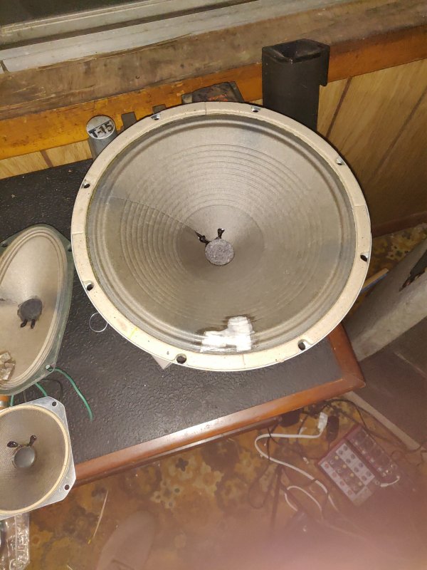

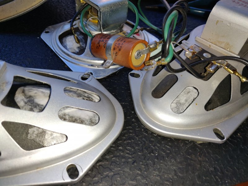

The glue arrived today...:)
After getting the chores done I worked up my nerve to do the patches on the speaker cones...
It was tough getting the patch through the cage I ended up having to use smaller pieces of coffee filter like paper machee...
The softness of the brush is kinda critical the cone paper sucked up the water in the glue and got soft pretty fast...
I didn't trust just a inside patch...
I wonder if I could get away with painting the cones with a light coat of flex seal to make them pretty?
I hide speakers behind grille cloth to make them pretty.
That sounds like a I wouldn't try it if I were you to me...:)
I found another place that was ripped in a woofer it's a good thing that the cone repair is so simple... I'd have never thought of it being okay to patch the cone but I'll try any repair method at least once...
