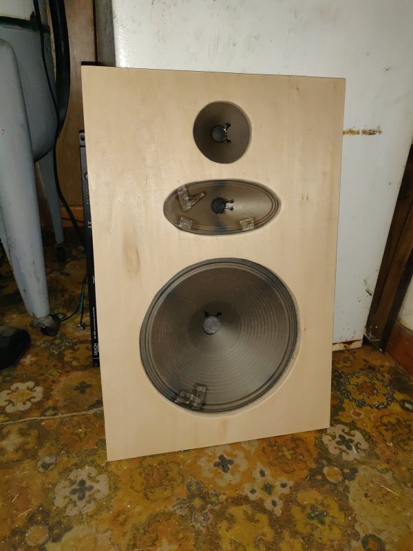

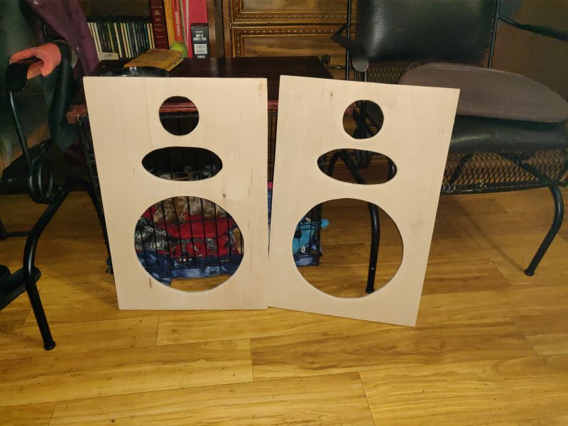

I messed up the first set of speaker soundboards bad yesterday... But it's like anything else try try again... :)
I had forgotten how hard it is to cut inside circles with a jig saw...
The second set is usable I'm going with pine if the speaker's test good... :banana:
I managed to get one set of speakers temporarily mounted before dinner...
I should be able to get the other set mounted and do a bit of test listening to see how they sound tomorrow...

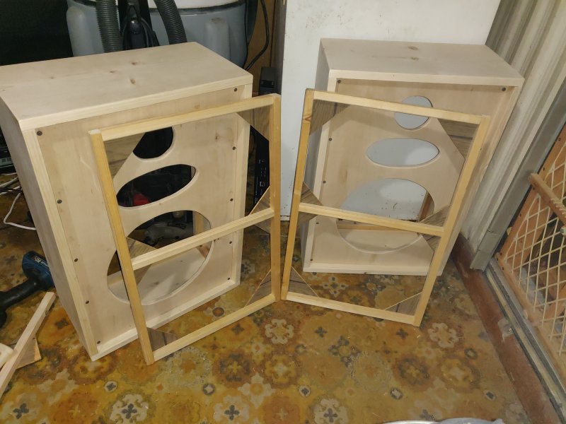

As always more pictures...:) The frames for the grill cloth are done...
There is so much more to doing this stuff right than meets the eye... Like glueing all the joints and braces... And predrilling the holes to avoid unwanted splitting...
It's refreshing to be able to just take my time and do it right... :beatnik::)
