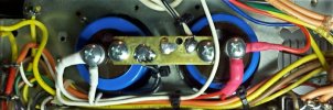

Marantz 2275 New Main Filter Cap Recommendations?
absolve2525
Super Member
Does anyone have a link to some nice caps that won't break the budget? I see them posted on Ebay for 50 or 60 bucks a pair. Thanks!
At this point I wouldn't worry about prices. They are getting extremely hard to find so even $100 a piece eventually will be the norm.
60 bucks for a pair would be cheap. Go to Digikey and do a filter search 50-51mm 63-100v. Cheapest I see is $31, thats a quality kemet 13000uf 63v with screw terminals. There's other choices around that price. I'm not even sure that's a good idea. Patfont's idea is quite possibly the best, considering the prestige of a 2275.
I think 100mm will go too high to set the top cover because the hole won't allow 50mm to go through the hole so it will sit at the edge. I have been using shorter 50mm caps but they are getting very hard to find as well. I used 100mm in the 1300DC but that's a much bigger unit.
