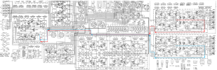

Hi Guys,
My 2325 lost the right channel while playing music. Pushing the hi and low mutlipath buttons brought back the right channel temporaily. I decided to DeOxit the switches and pulled out PU01. The right channel output retuned and reinstalled PU01. The right channel again stopped working when I reinstalled. I had previously recapped and changed all transistors on PU01. Here are my findings so far while connected to DBT.
  • The speaker relay only engages while plugged into DBT.
  • Speaker relay does not engage when I plug into my Variac @120VAC.
  • Swapped Pre(PE01) from another 2325 and no change. Reinstalled original Pre.
  • I have a signal tracer and signal generator and fed 1k sine wave tone to AUX. Verified signal output on PU01 pin 13 and 14 while speakers are not switched on.
  • Good signal on pin 13 and 14 until I engage switch on Main SU01-8 and Remote SU01-7. Then only Pin 13 work and Pin 14 loses signal when Main speakers switched on.
  • Losing signal at pin 13 and 14 when Moving balance to the right.
  • Checked and reflowed solder points on P01 and no change.
Thank you for your input

Suggest you cross-connect the left and right channels by using the main in/pre-out jacks to see of the problem follows the right pre-amp to the left channel and vice-versa. This should determine if the issue is in the right power amp or the right pre-amp. If the problem persists on the right channel then it will indicate a problem with the right power amp module. If it migrates to the left channel then it is an issue in the pre-amp. Since you swapped pre-amp modules and the problem persisted I am betting there is an issue with the right power amp module. Also, are your main and remote speakers 8 ohm? if both are connected you are running into a 4 ohm load, if they are not then you could be overloading the power amp.
I have two 8 ohm 200w resistors connected to the main output while testing.
Cross-connected Pre/Main jacks and found right main to be the source of problems . Swapped out right amp from another 2325 and the receiver is working.
Regarding the bad amp, I previously recapped and changed transistors on the main board(see attached pic for list of parts). I’m thinking of testing the output transistors and then moving over to signal path transistors.
