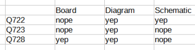

Looking at a Marantz 2330, and finding some puzzling differences between P700 in person vs the schematic.
P700 has screening and holes for Q722 & Q723 and both appear on the board diagram, but neither is installed on these 2330 P700. Q722 is in the schematic, but Q723 is not.
Q728 is on the real board and diagram, but not the schematic.
Were there any known revisions? Service bulletins? Are there any documents that might help clear this up?
I've consulted (digital, not paper) service manual, US and Euro schematics. None tell any different story. I've googled quite a bit.
Finally, the parts list in the service manual agrees with the machine here: no listing for Q722, 723, but Q728 is present.
Edit:
Further time with the machine makes it look like the schematic should have said Q728 where it says Q722, that Q728 is doing what the schem says Q722 does. Hope this saves somebody else some time...
A second error: R718 and R719 are in the schematic as 33ohm, but are in the amp and parts list 150ohm resistors.
