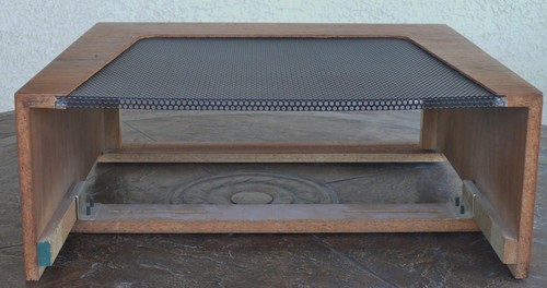

Hey team. Bought a nice 1250 in a wood case.Haven't received it yet but I would like some help identifying the wood case. The 1250 is floating inside the case. Is it a Marantz case? Model #?
I have a WC-1 case. Slightly different bottom. Why is the 1250 floating inside. How should it have been mounted. fyi I don't have this in my possession yet,about to be shipped.
yes WC-1U i just bought one for my 4140 they have an adjustable bottom to fit different amps.
the adjustable board should be moved over the rear feet (feet removed and the fronts ) tighten the 4 screws to hold in place then put screws and washer in where the rear feet went through the slots to hold it in place. there are felt feet on the case to set it on. i think thats how it works anyway still waiting for mine. that case is pretty rare and worth some bucks itself
Thanks for the confirmation. For some reason the owner just slide it into the case and lived with that.
