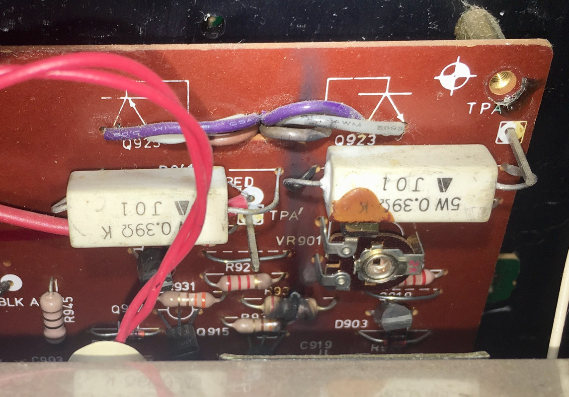

I picked up a 3245 just today, along with an MCS turntable and cassette deck. The 3245 powers on and is working. However, the right channel fuse button was popped out. Upon resetting, I blew a woofer. Sadly, I was also testing a pair of old Pioneer CS-66e’s. So I now have to find a replacement woofer for that. Anyway..
I see a charred resistor on the vertical board toward to back of the chassis. I didn’t see/smell smoke when I blew the woofer, so I think it was already there. The resistor is shot, so I cannot determine the value. On the board, the resistor label is charred so I can’t read the third number (R93_).
I’m not a tech. I can mod, troubleshoot, and repair basic guitar pedals and such. I can somewhat use a voltage meter and my soldering skills are adequate.
Additional concerns:
1. As far as high voltage, I am unsure what not to touch. I see the huge caps over on the left, I’m staying away from those. What about the board in question?
2. Seems about impossible to remove that board to replace the burnt resistor.

How do you like your 3245? Have you opened it up? I could use a shot of the vertical board so I can identify my burnt resistor.

How do you like your 3245? Have you opened it up? I could use a shot of the vertical board so I can identify my burnt resistor."
You should be able to see what it is on the other channel, they are close to a mirror image. I have a manual at a different location. I will let you know what it is for sure when I get it. Maybe tonight.
@Psychophonic LOL. I saw that CL listing and passed it on to fellow ak horder. In my heyday Id have been all over it! Knowing most of that stack of MCS & Adcom would need work I passed... Already have piles of gear to fix. GLWS on MCS stuff and GFA-555...
Thanks for the replies guys. I don’t think I want to mess with this one, I just don’t think I have the skills to repair it. Removing the board is not a job for me. It looks like I’d have to disassemble many things to get to it. It’s a bummer, but I’m going to let someone with more experience have at it.
