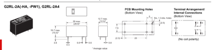

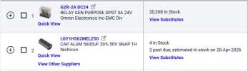

What part # is printed on the relay ? Mouser likely has an Omron drop-in replacement.

You need to de solder it from the board to be able to clean it properly. But new relays should be available. Dave should be able to steer you to the right one.
Athanasios
What part number is printed on the top of the relay? A photo of the footprint would be handy.

I guess that it may look like this on the bottom, based on some for sale in China.
Hoping there's a new (current) equivelant.
I have an RX-300U too. I have been away from my bench for a while, reading this thread seemed like a good opportunity to get back into the hobby. Certainly corrosive glue, and more black plastic than higher end and older Yamahas, so have to be careful not to break anything. The relay that @avionic recommended looks like a good match, same circuit etc., I'm going to order one. Mine has intermittent channels etc. Definitely have to clean the pots etc.

Just curious: Did you find some replacement 5600 uF caps? I looked a little but so far haven't found any I thought looked suitable . . . I don't want to change the sound as I think it's awesome as-is. The glue on mine is making the jumper wires corrode.

I was buying another amp and asked the guy if he had anything else for sale. He had this RX-300U for almost free. Since I like most Yamaha with variable loudness I bought it, at least it could be a doner for screws and other bits. This thread made me decide to spruce it up. The filter caps on my unit seem fine, so i don't think I am going to invest in new ones at this point. I'll do the same as you, clean the pots and the glue, replace the relay if it seems faulty. Most of my channel cut outs are probably the pots, we'll see.
Those Nichicons look like a good choice also. Thanks for sharing!
