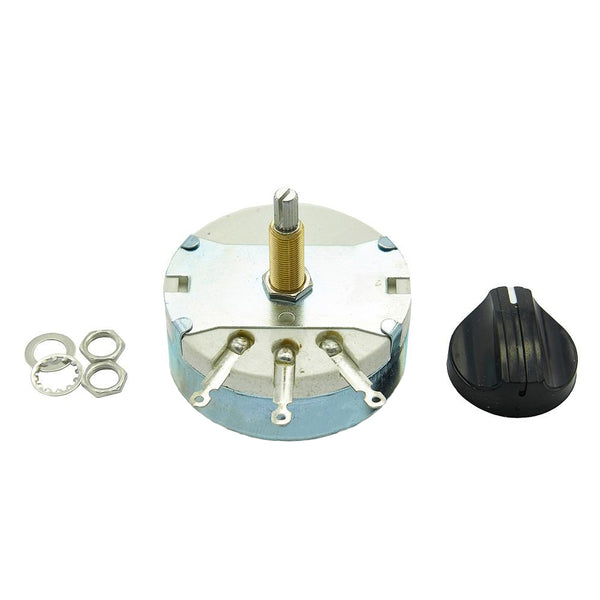

A rising response on the Heil was left to give some flexibility with a adjustable (4ohm) L-pad-so highly recommended, unless compensated.
Myself am a fan of l-pads on mids and tweets.
FIY-the l-pad will shift the crossover frequency slightly upward a little-depending on what's dialed in.

Partial parts list. As mentioned, I purchased the AL cased power resistors from Amazon Used to get them from Meniscus-but they went out of business.
A FIY-with this you could easily leave the cabs stock-and simply remove all the stock components except the Great Heil.
I would recommend at least a HF L-pad.
They need to be 4 ohms.
They can be purchased here.
I used this for a crossover board
And Dayton Audio # BPA-38AG binding post.
Myself, I would also add one to the midrange.
Nice thing about l-pads @ zero attenuation, they are effectively out of the circuit.
