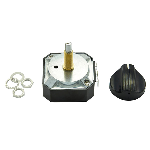

Lpads:
4 Ohm L-Pad Attenuator - 50 Watts
4 Ohm L-Pad Attenuator 50W. This L-Pad provides a constant 4 ohm load on the input terminals regardless of its setting ~ it will not interfere with a crossover network. There is a huge amount of new 4 ohm tweeters available, now you can attenuate them to fine tune and match your system.
