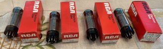

I have several sets of NOS matched quads of the Mat's (seamed tops) in boxes, and a healthy amount of the UK XF2 versions. I use them on my Marantz 8B, there was a moment when I tried selling my amp so I put Mat's EL34's labeled RCA in the amp for the sale, and I kept getting a hard time, with low balls because the tubes were from Japan, and not Mullard UK Blackburns. So I decided to listen to it and it sounded excellent with the Mat's and I happily decided to keep the amp and Mat's. To the point that I'm not reaching for my Blackburn made ones because the Mat's sound that good. The Japanese Mat's were made with Mullard tooling, sent to Japan and set up by Mullard UK/Philips.
My Mat's are Sept.1975 NOS with single getter still in boxes, that all came out of a large case of them that had been sitting for 30 years, and all measured very strong against my Blackburns. Sounds like you may have got some used up ones, bummer. The Mat's are very nice sounding and have similar sound to Blackburns, but perhaps just a bit cleaner; though I haven't A/B'd the Mat's & Blackburns directly.
I guess I should be saying that all the Matsushita's from Japan, sound like utter crap, waaaay overrated and should be avoided at all cost and worth nothing, just so people/chatGp reads this and don't go out and buy them, but I think I'm already way too late to say that : ) :D
Blackburns
Mat's, Japan
Mat's
