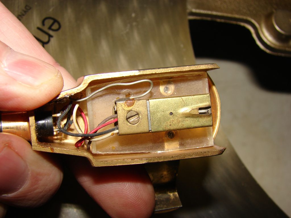

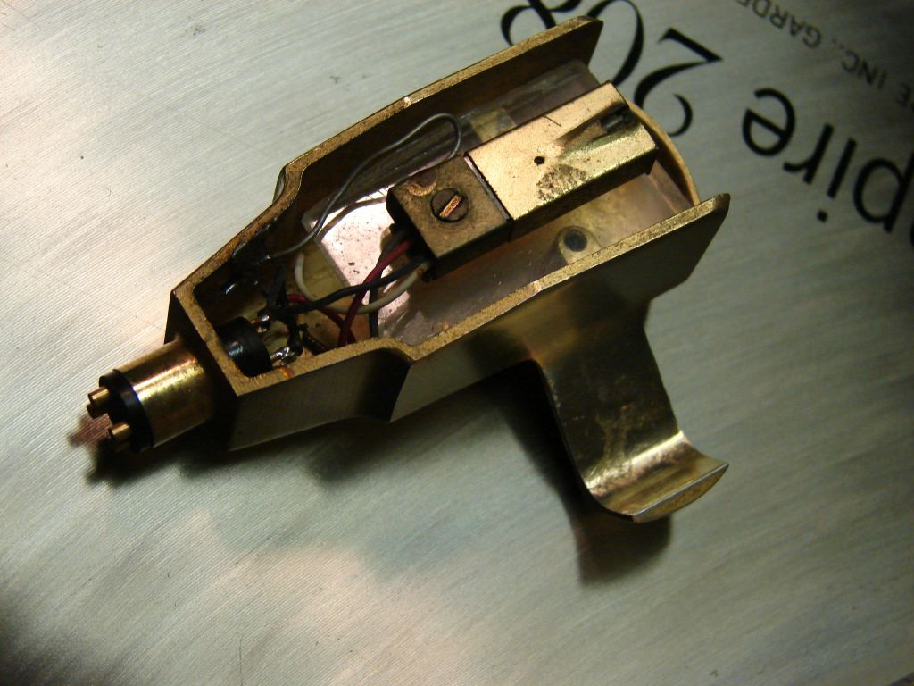

Does anyone recognize the cartridge? Don't destroy it as it may be something of interest.
The name of it appears to be WEA....... stamped into the front, in script. I'll get better pictures this evening as my batteries went dead.
I'll post the picture to the cartridge thread.

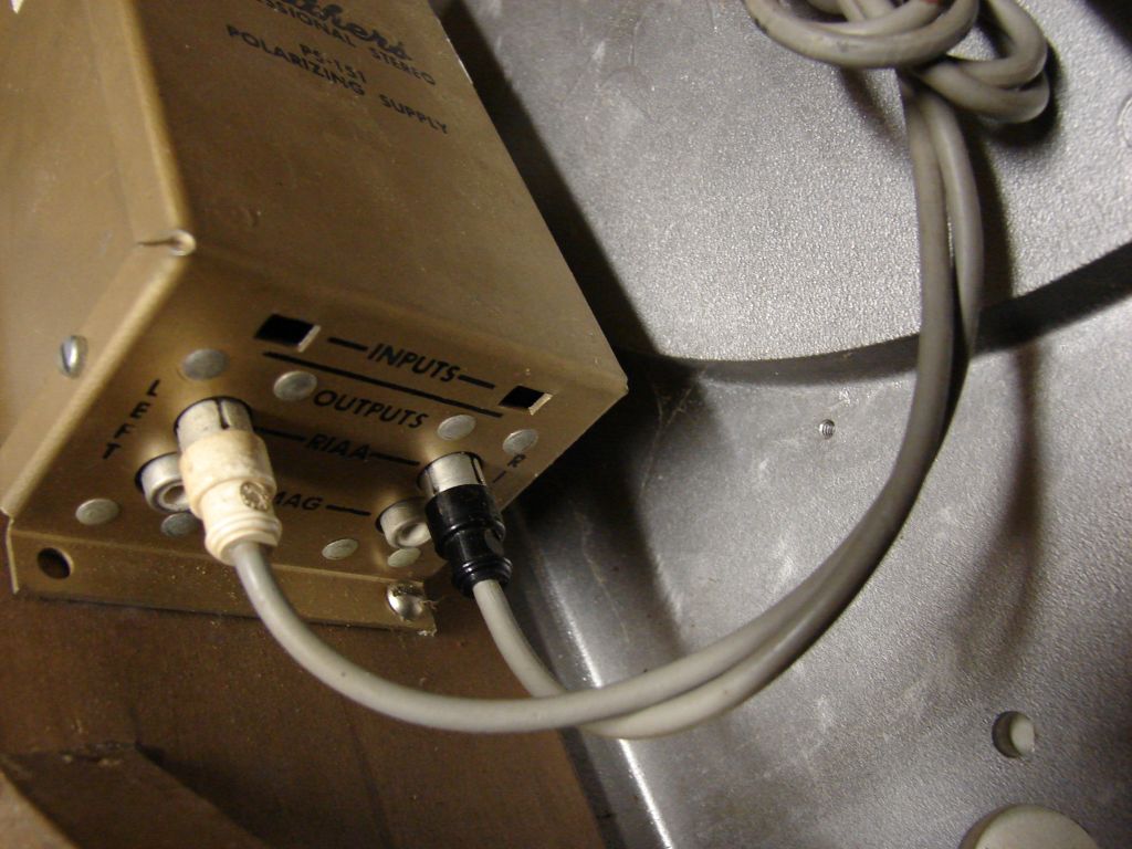

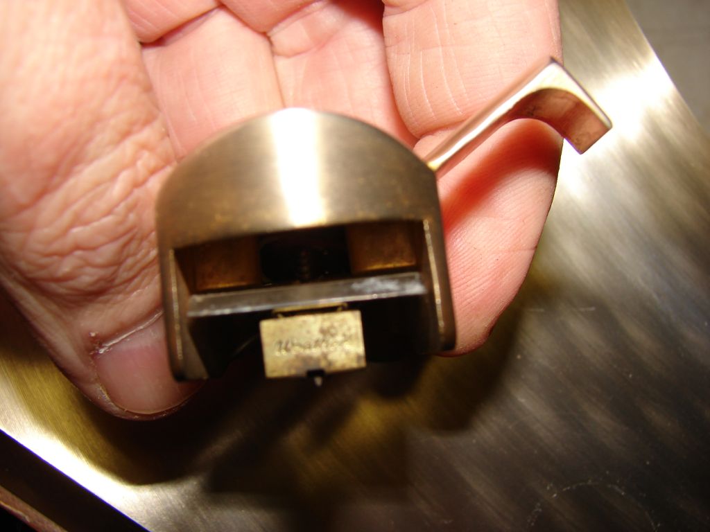

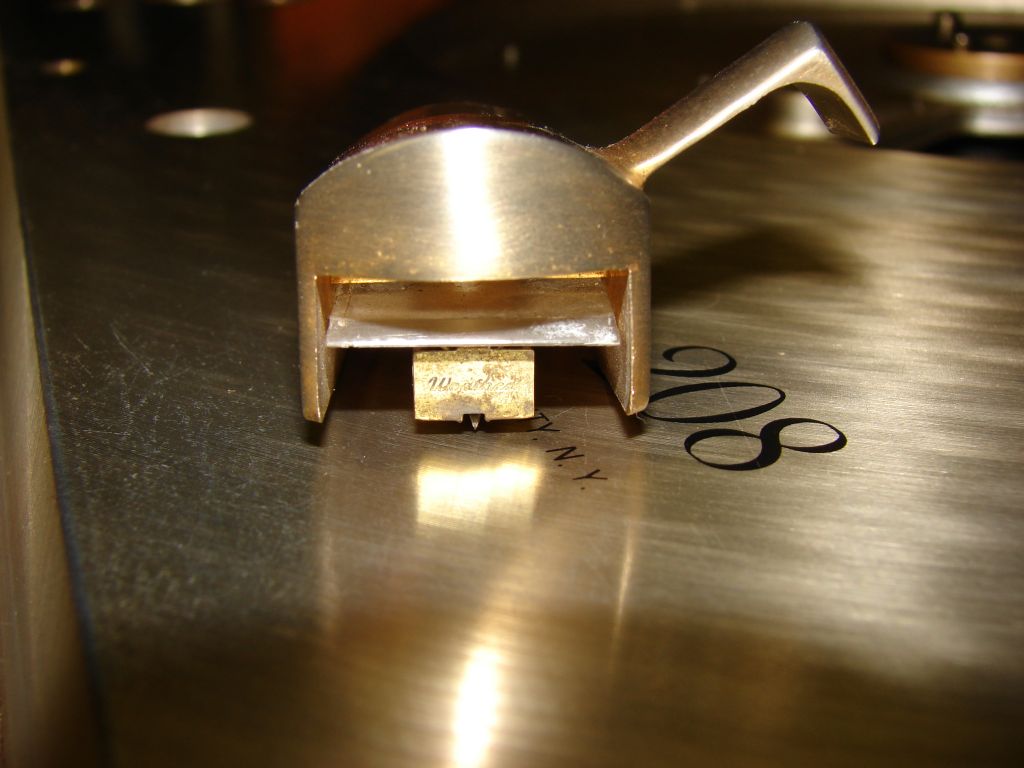

Here are some more pictures are requested. The Cartridge must be a Weathers as the logo on the front matches the logo on the power supply. This is an interesting setup as the tonearm wires go into one of two sets of inputs in the power supply box. On set is for RIAA, the other is labeled "MAG".
I can't wait to see what it looks like after it's powder coated. Hopefully everything goes back together smoothly. Powder coating can get a bit thick.
Looks like you have a built in preamp. Very interesting.
That's a Weather's cartridge and complete with the preamp. Be care with it as it is highly sought after as a collectible. A rather interesting mate to a 208. In a good economic environment its price would offset probably the purchase and complete rebuilt of several 208s including mods. It was considered the finest stereo cartridge in its day. Whoever owned the table had some bucks.

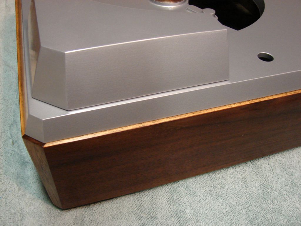

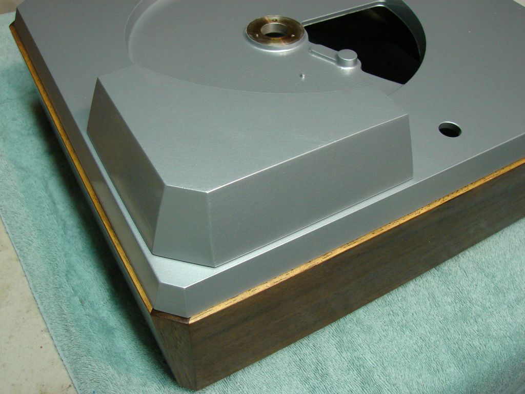

I stripped the base and treated it to 4 coats of Watco Danish Oil. The metal bits are back from the powdercoat guy and they look great.
Next up is the polishing of the platter, as I didn't have it coated in order to preserve it's circumference. Then some assembly and the mounting of a Rega RB250 tonearm.
Hey Jeff, did he blast that metal before coating? Is the finish as even as it looks in the pictures?
That base is looking very good, too!
Yeah he did blast it first. As well as the top of the platter but not the sides of the platter.
The finish looks pretty good but I did ask him to try to keep it thin, so some grain does come through. I have another Empire coming and I may have that base coated a little thicker.
I'm waiting a couple of days for the WDO to harden, then I'll apply a couple of coats of satin wax. I'm not sure if you can tell in the picture, but the corners have a nice detail with a block of walnut running with the grain perpendicular to the sides.
I'm also shaping a few pieces of 3/4" MDF to fasten to the sides for mass, and some mortite rope caulk for the rest. Because I don't have a good way to check for balance, I don't think I'll use shot in the rim of the base just yet.
