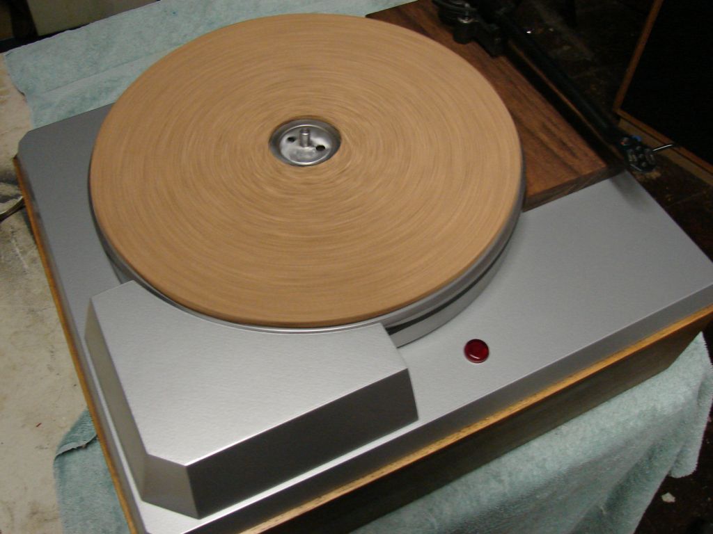

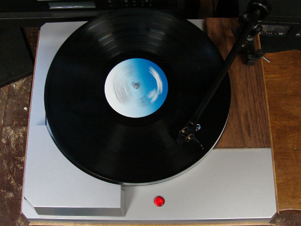

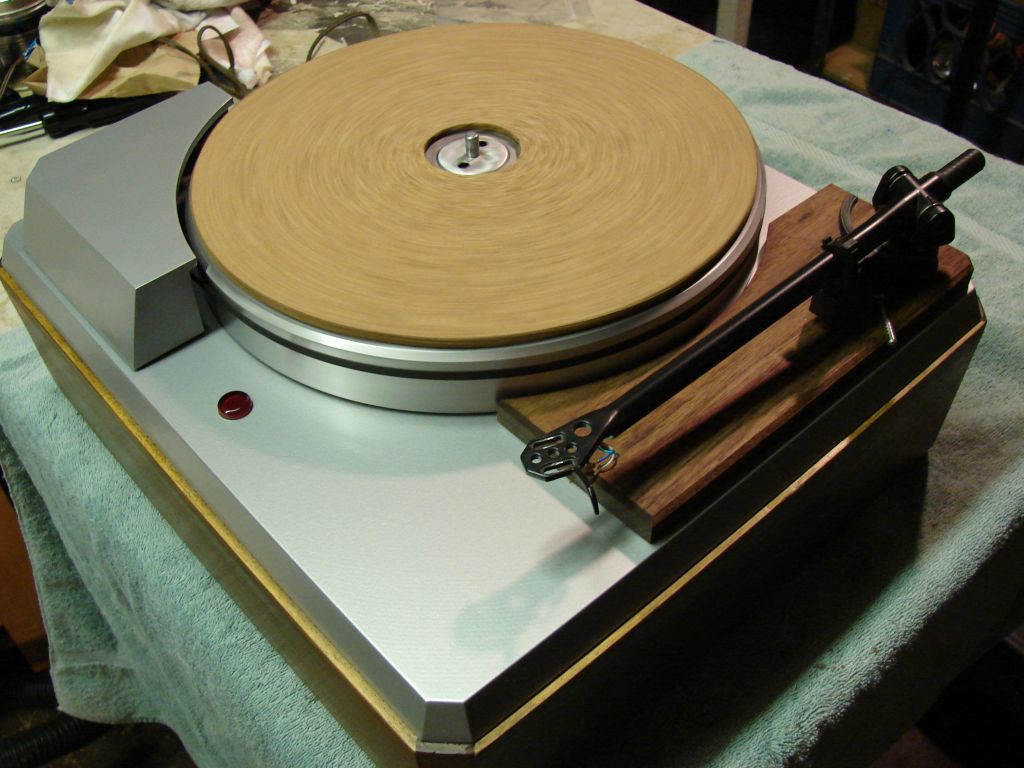

I visited ejfud's magic kingdom this morning and we (he) fabbed up this armboard. I had tiny slices of time this afternoon to get this much finished.
The arm is just sitting there, I have to finish mounting it and the cartridge, then I'm set to go.
There were some powder coating related issues, the lamp hole had to be reamed out, and the screws that I left in the holes for mounting the start cap/etc just twisted off when I tried to back them off. Another trip to Ace and all was fine. I'm done for today...
You can probably get by with just 2 screws (mounted from the backside) to preserve the clean look of the armboard but it's up to you, just maintain 222mm spindle to pivot for the Rega tonearm. The distance from the top of the armboard to the top of the playing surface should be around 1.1" That will get you close to what a Rega turntables setup looks like (regarding VTA) You may have to adjust the arm height to optimize it, but you'll be pretty close.
We used three, one in back and two down the edge.
It's sitting pretty much gnat's ass right now. I just mounted the cartridge (NOS Grado F3+) There is still one ground wire floating around underneath, I need to go back to my pictures to figure out where it goes.

Hey it's spinning!

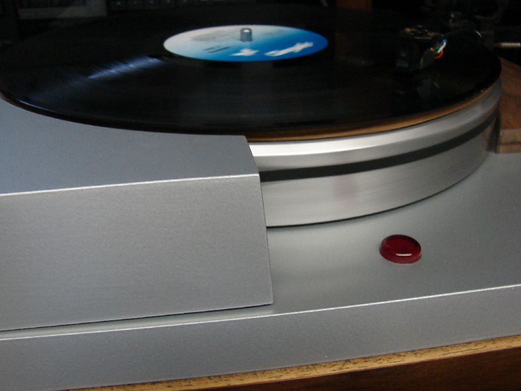

Anyway, I have to be honest and admit that when you first said you were going to powdercoat the plinth, I thought, "why doesn't he get it refinished as close to the original as possible?" :scratch2:
However, after seeing it now, it does look very nice and preserves the general Empire look. And, I realize that trying to refinish it in the original way would be very difficult if not impossible. :yes:

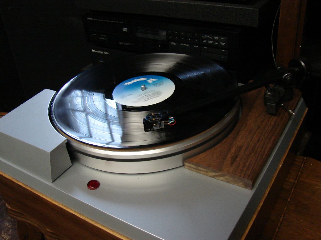

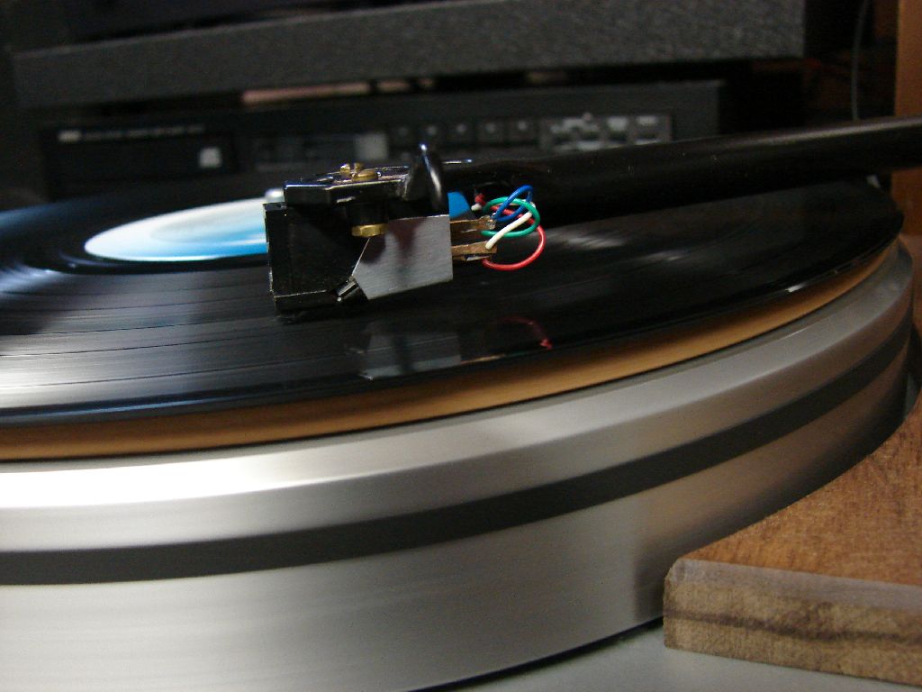

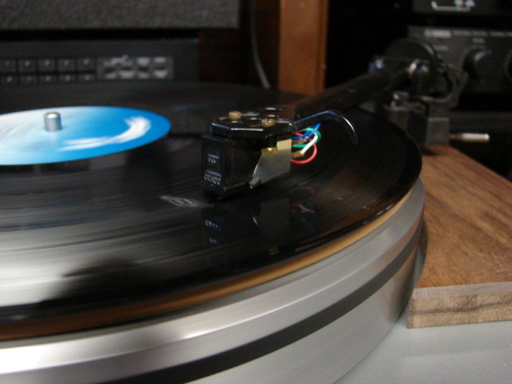

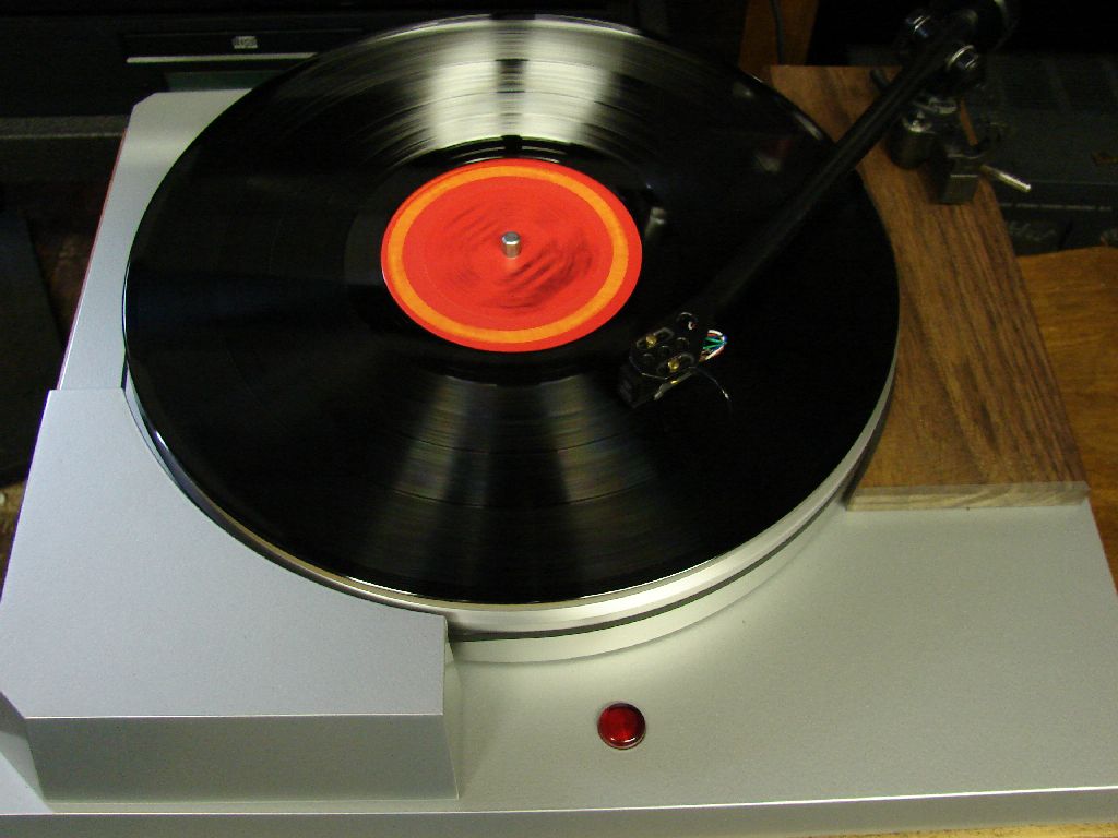

I mounted the cartridge and set up next to my rack. I'm using the Bellari VP129 as a phono stage into my Bottlehead SEX amp, and of course the Cornwall II's.
I need to do some more listening, and I also know that it takes the Bellari a while to warm up, but so far my impressions are very favorable. The table is quiet as a stone.

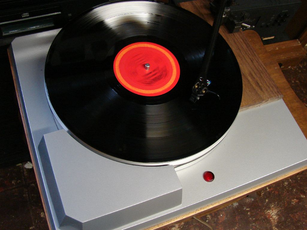

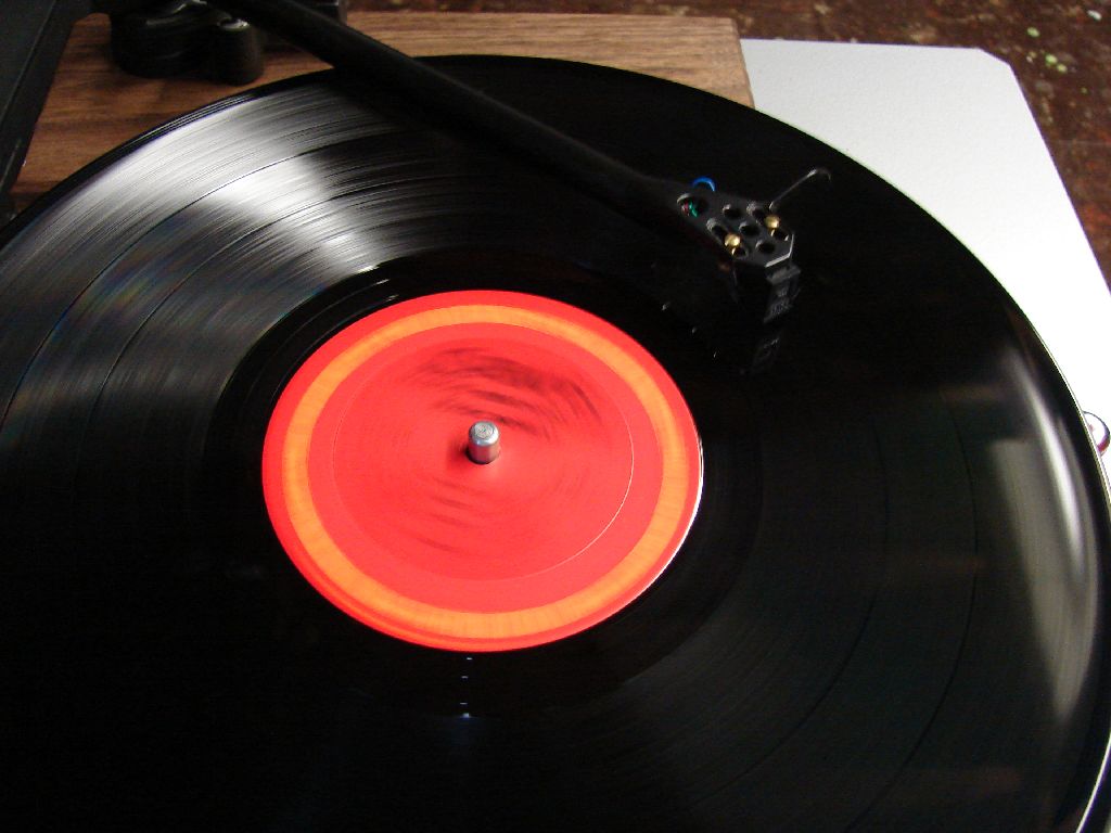

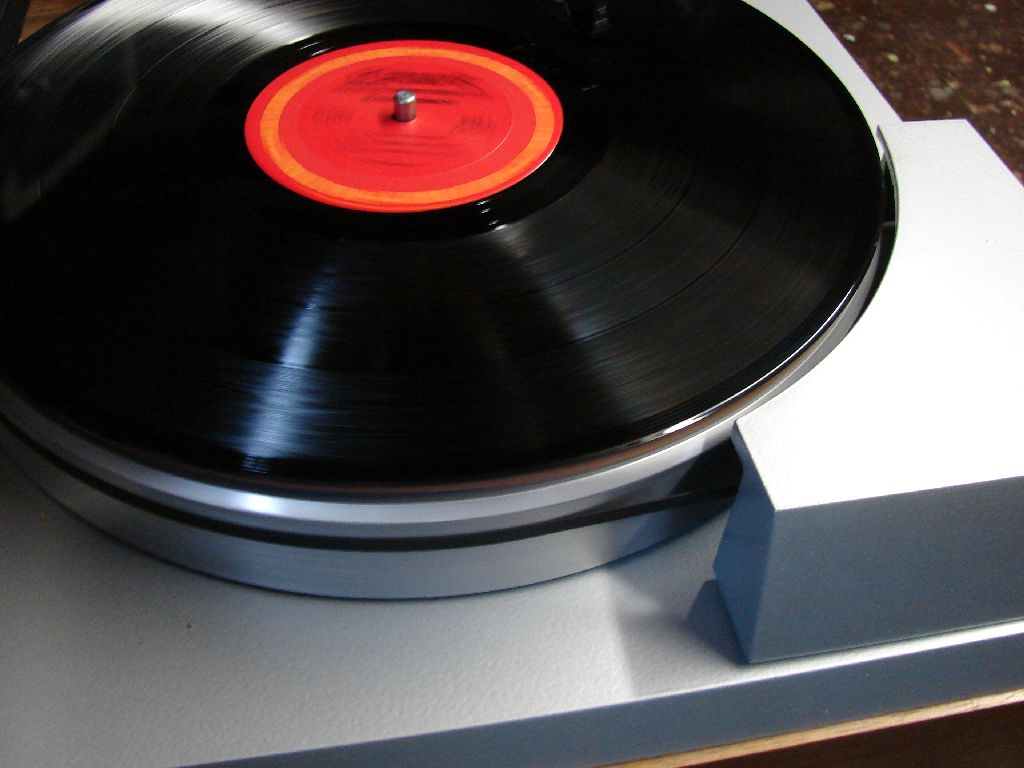

Here are some glamor shots.
SpecialIdiot
Man your table is beautiful !
I keep coming back to this page to look at it.
The finished project it stellar.
