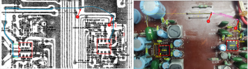

Ok. I've been doing a little troubleshooting with just a DMM. Turns out you can actually do quite a bit!
But I'm getting some very screwy readings at IC303. That chip is same 4558D op amp as in the 480. I'm getting -12VDC at pin 8! That's supposed to be +VCC. It should be POSITIVE!
R302, C309 and R311 are also NEGATIVE 12V! R148 farther away is positive. IC301 (4558D) pin 8 +VCC is also positive. Further down the circuit it goes directly to +12V p/s input. IC303 is isolated by the 1K resistor. But otherwise seems connected to +12V. So how can IC303 be negative at pin8? Wouldn't there would be a big short then?

The other odd discrepancy is that this is the earlier model 580, but the PCB seems to be slightly different than what's shown in the manual, but also not the later one. There's no black wire jumper between R311 and the PCB trace to C315 which is shown in the PCB trace image in the manual for the earlier S/N's. Instead there's a standard bare wire jumper on the pad to the left of R202 which goes to the PCB trace connecting to Q303 and L301. That trace doesn't exist in the later PCB.
If that jumper was there it might cause a short because R311 is -12VDC and C315 is +12V! Still wondering how it's not shorted somewhere else...

Something is not right? You measured +12V at IC301 pin 8, but -12V on R302 and C309?
  1. First, check to make sure that you have 3 jumpers in place in the path from pin 8 to pin 8 (dotted lines) and that they are connecting the right traces.
  2. Since the voltage polarity changes from + to - at R311, check for bad solder or cracked traces in that area and double check you readings.
  3. Also, note that IC301 and IC303 are installed in opposite orientations as noted by the notch in the IC. Make sure you were on the correct pin when you measured the voltages on pin 8.

You're correct about that. Something is definitely not right! Don't get it...
This board is slightly different that any board shown in the manual, as I noted in post #3 :
There is no insulated jumper wire (the curved one) on this board. It definitely looks like there never has been. There is also no board trace where you have it circled. That's for the later board, if a trace is there. This board is the earlier board in most all respects.
But this board, as noted in post #3, has a standard straight bare wire jumper, not shown in the manual, mounted on the board on the pad to the left of R202 and which goes to the PCB trace connecting to Q303 and L301. That trace doesn't exist in the later PCB. Maybe it's a later revision, or maybe they just accidentally left that jumper out of the manual.

Here are the two points on either side of the jumper that is not on your board.
Can you measure the voltage at point 1 and point 2 with respect to ground.
I think this should correspond to the -11.4v and +11.97v you provided before.
If this is what it is, then we need to investigate why.
Please note again that the curved jumper, which would be an insulated black jumper wire, does not exist and has never been present.

That's pretty obvious. There's no curved jumper. The long jumper, that's used instead, that's shown in posts #8 and #11, is at -12V.
That's why I'm now tracing from it. It goes to Q303(c). That should be +12V. But it's -12V.
I suppose I could temporarily remove the long jumper and add the curved jumper to see if that corrects the voltage at IC303. But the other issue around the bias circuit would still be present...
