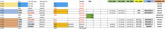

I also changed some transistors. Here is the new SUB_LIST: The last CHANGED_TO Column is what I have now:
