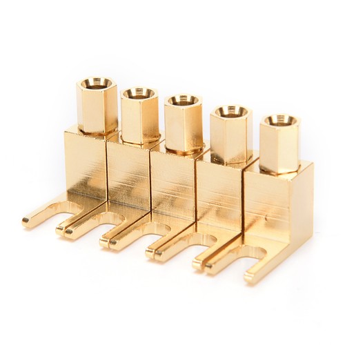

On the back of my Marantz Imperial 6 there are this old type of screw binding posts. Right now the bare cable is wrapping around them as you can see in the picture I attached to this post.
I would like to make an easier way to plug and unplug the cables without changing the binding post type and I was thinking that adding a connector at the end of the wires might improve the situation. Only problem is that I do not know what type of connector I should use with these screws and that is why I am asking to you guys.
Note also that the space between the two screws is barely half centimeter.

Here's another option, I use these on my vintage McIntosh amp which has screw terminals. You can find them in all the usual mail order places.
Am I supposed to put a banana plug in them?
Yes, banana plugs will fit into the holes of the posts that are sticking up there, that is their main purpose. Also the posts screw out, then on the other side of the square body (not visible in the picture) is a hole that you can use for bare wire, which is what I do. Then screw the posts down to secure.
