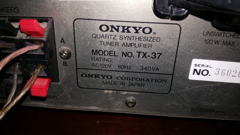

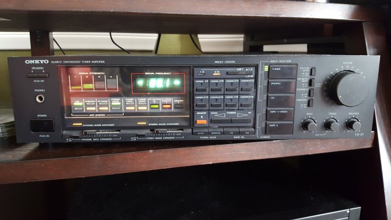

I'm the original owner of the Onkyo TX-37. Bought it in high school with money from my first job. I've used her ever since as my only receiver. She still works but channels cut in and out and crackle (mostly right channel) and it's slowly growing worse. The pre-sets also don't save for long periods of time (no biggy). Otherwise when working, she sounds fantastic. I have well over 2000 albums from circa the late 40s to late 70s and this amp does a great job of making those recordings sound fantastic. My 2500 plus CD collection also does well with her as does my connection to the TV for sports and movies along with connecting to my computer/phone for Napster, Amz Prime, etc.
Do I fix or let her die? If I fix, should I use the centers found on Onkyo USA support? (I'm in the Los Angeles, Long Beach, South Bay area). Any guesses on what the cost/bill may look like for the likely repairs?

Cutting out and crackle might be a speaker protection relay needing replaced or maybe just dirty switches / pots. Loss of memory sounds like a backup super capacitor. If it were me, I would get it repaired. When does the crackle / dropout occur?
(in my best wise-guy mob voice): "its totally totally fixable"
and for not much money if you know how to poke in there.
I think I recently did a TX35 which was silver faced and in the same genre of that.
I'll agree on the dead super cap and probably bad protection relay contacts. I like Onkyo gear and since you've had it this long I'd lean toward fixing it.
Maybe try turning the volume, tone and balance knobs back and forth a bunch of times with it powered off to see if the crackling noise gets any better. If so then you might just need to deoxit your pots.
The preset issue would take soldering to fix but the part is only a few dollars. If it's the protection relay causing your issue, same thing, few dollars in parts and a bit of soldering.

Fix that bad boy, doesn't sound like anything even remotely difficult. I'm betting a deoxit bath, relay contact clean/sanding and she'll respond well.

This is an old post, but just in case anyone else is looking for info on the Onkyo TX-37. They do not have protection circuitry, so if there is an issue with the receiver passing DC voltage or worse to the speaker outputs, you could lose your speakers (there are modules that you can build yourself or purchase and then install to add protection circuitry). Secondly, these do, in fact, have an STK module installed (STK4913 to be exact) to handle both channel outputs. Replacing the STK is not difficult, IF you can find a replacement - that is the difficult part. The STK's are no longer being mass produced, so your options for acquiring one will be used (not a great idea), ordering one online (some are ok, but there are lots of cheap counterfeits out there also), or the better option would be to remove the STK and install two of the TDA7293 modules. There are some YouTube videos showing how to install these modules instead of using the STK. The sound quality is supposed to be excellent from these, and the benefit is that you can build them yourself, or purchase them complete for around $8 to $10 each, for a total of around $20 for two high quality channels of audio. These do not include any protection circuitry, but you could add that yourself as well.
