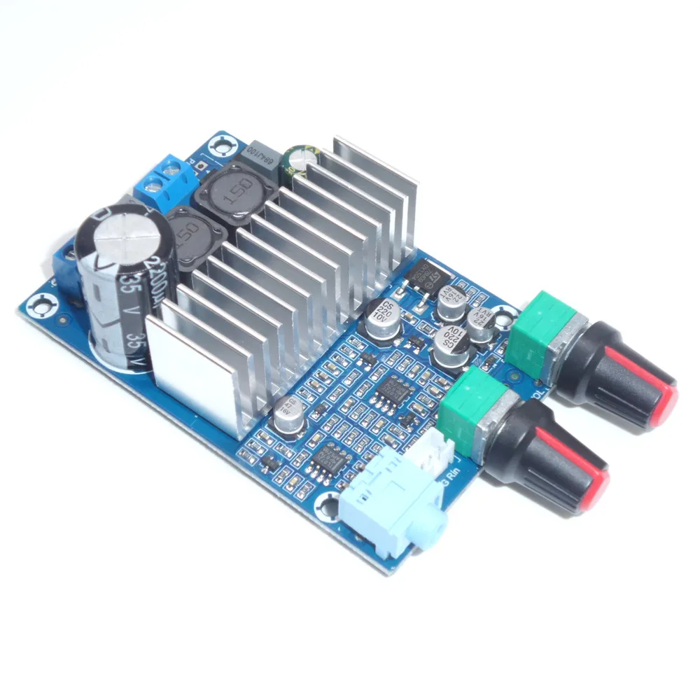

I'd consider this $12 TPA3116 mono sub amp which features an adjustable crossover. With a $10 24V laptop power brick it should have plenty of power.
Actually I've order one of these for 20$. Should do the job of filtering down to the correct frequency on line level, then I'll output from a regular power amp to the bass driver, without crossover...

Hi Jerry, In the end I opted for a different kind of active crossover connected in the line path to a separate amplifier. However, mysteriously, when I connected the bass driver without crossover to this, or any directly to any signal source for that matter, I got little or no output from the speaker, certainly no sub bass. I tried all kinds of set ups and the dual voice coils independently but still no result. So I gave up and reconnected the crossover as it was, and it works perfectly (only with the crossover set to 120hz). I can't see a reason for this, but the Canton bass driver only seems to work when connected through this crossover circuit. Or is that insane?
