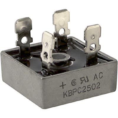

I replaced the bridge rectifier in my PL300 sii. I normally take a picture before doing something like this, but this time, I relied on my 72 year old brain to remember what goes where (BIG mistake). Could someone who has a working 300 post a pic of the bridge rectifier in circuit so I can double check what I did? Thanks.

Bridge rectifiers are easy. There are only two AC inputs and two DC outputs. Of course the DC output is marked (should be) negative & positive.

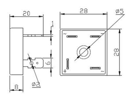

That's my problem. I ordered the correct replacement. The only marking on the replacement was for one pole of the AC. I know that the diagonal pole is for the other
AC input. My concern is the other 2 poles for the DC out. I just want to make sure that I've got the right wires going to the right place on the DC side. The amp is a work in progress so I don't want to ruin anything by having the wiring incorrect.
plus should be the blade that faces the other way

That is the way I have it wired. I am getting 155.2 v across the DC connections. Relative to ground I am showing from the pos side 100.5 V. Neg side relative to ground I am getting -65.8 V. Does that sound correct?
I see from the schematic for the 300 that I should be seeing +70 and -70 volts going to the channels. That is why the 100.5 V showing on the positive side concerns me. Is it possible that I have a defective filter cap?
