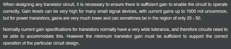

in regards to hfe ratings, keep in mind we are still dealing with an audio amp not an electron microscope in terms of accuracy and component tolerances (+/- 20/10/5/1 % vs +/ 0.01/0.001/0.0001 % type of thing). the circuit will determine how much hfe is needed for the task/output designed. upgrading hfe 100 to 500 would be overkill vs going from 400 to 100 may cause circuit/performace issues.
what is the universal sweet spot hfe, cant say that i have researched that question. establishing a +/- hfe for various circuit positions would be useful. once again, havent ventured down that road yet.

going high or higher on frequency rating can be a bad thing. when using a transistor in the hifi spectrum 20hz-20khz there is no benefit to having a transistor upgraded from 1 mega-hertz to 100 mega-hertz. if anything having a higher ft increases the chances of high frequency oscillations and this isnt a radio-frequency amp.
if the transistor is limited to handling 1 mega-hertz it helps to ignore the mf/hf/vhf noise that can sabotage an audio amps performance.
**too many altium adverts on the page, although content informative
