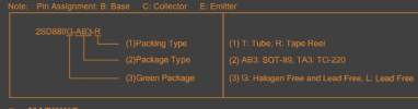

using the 2sd880 as a random example, there are some spec sheets available. and for vintage gear thats a plus, some components are almost non-existent when searching for basic specs.

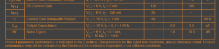

something to watch out for as well, if specification shopping/comparing, would be if a transistor has "noise figure" spec. they can be difficult to find an upgrade due to wattage limitations and Vce parameters.
Screenshot 2026-05-11 at 22-14-46 KSC1815 - NPN Epitaxial Silicon Transistor - KSC1815-D.pdf.png
a popular replacement/update/upgrade example would be the above ksc1815. just one of many out in the active inventory market.

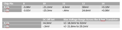

Well, the charts didn't help. The original chips (currently installed) are closely matched to each other (1st attachment below) as well as the replacements I got (second attachment). However, comparing the original chips to the replacements it looks like completely different sets of chips. I did notice the DCV readings I have now for both channels match where I was on my May 6 post which leads me to believe the J2 ribbon cable was likely the cause of my original hum and high left channel high bias all along. There is a bit of a difference between the original L/R channel chips on the resistance readings for pins 1 to 9 and 1 to 13. Could that be a culprit for the off bias readings on the R-Ch? Is it off enough to worry about?
So, I tried swapping the original chips I had installed- right to left and left to right. A bit of a change but not much so likely not the chips causing the off readings. For reference, pins should read: 8=-3.3V, 10=-25mV, 11=0V, 12=+25mv, 14=+3.3V. All DC. Is it worth chasing this down? Should I consider trying the new power transistors or leave it be?
some circuit and chip variances will make things less than perfect (hence +/- 5% or 10% is a tolerable tolerance). resistance measurements on the chip pins helps with looking for unusually low resistances (shorted internally or low resistance) and considered to be a crude/low-level component test (still useful though). in terms of overall chip functionality, only in a circuit with power applied and design spec load connected will it show if it works or not (multi-pin mystery box).
are the numbers with or without dim bulb and is there a load connected?
the numbers in post-119 are the original outputs (power transistors)?
