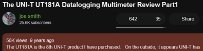

Screenshot 2026-03-12 at 21-29-06 The UNI-T UT181A Datalogging Multimeter Review Part1 - YouTube.png
youtube.com/watch?v=PjNXbKlr3MI
*enjoyable/nerdgasm review/test/eventual break + autopsy + redesign + repair (part 2 vid carnage)
nerding out about diagnostic gear gets addictive and expensive, and now back to the original topic.
