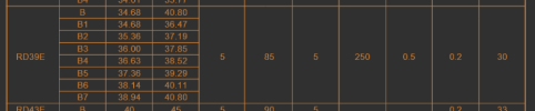

Do you by chance have recommended replacements for the zeners? RD39EB, RD13EB and RD12EB? Best I can figure is a 3.9V 1W; 13V 1/2W and 12V 1/2W. Does that sound right?
rd39e (b level of tolerance) would be 39v 0.5w judging by the zener spec sheet.
bumping them all up to 1w wouldnt be a bad idea, something i usually do. should be some common drop-in replacements on the usual parts sites (digikey, mouser, others...).
