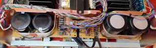

I know what you're thinking: "doesn't he notice those relays on the buffer amp look just like troublesome relays the reck havoc in the C-90?" Actually yes, I did notice and although they are not currently causing a problem, I figured it best to go ahead and replace. So, they're on order along with RY401 and RY402. Thanks to MattiaM's post for providing the part numbers. Now, what to do with those big filter caps....
The filter caps. So good looking and likely still decent but just didn't make sense to do all this work and leave 35+ year old caps in there. Took quite a bit of heat to get the solder off there so first had to clip the posts and found it best to use solder wick to get as much solder off as possible- and get as much as possible. Then used pliers to align the post with the slots in the PCB as well as break the connection to the small amount of remaining solder. Then I took a knife to cut the glue, and with a little care- they pulled right out. Got some glue to clean off, but going to use these Cornell Dubilier Knowles 15000uf/100V caps (DigiKey 382LX153M100B062VS). Same diameter but and a bit shorter, but they have 25mm lead spacing so the pins will just fit into those two slots I circled on the board. Same diameter means the copper clamp should still hold them secure. We'll see how it goes.

Still waiting for my relays to come in, but thought I’d do a little preliminary work to see how the new caps fit. The caps have (5) pins- 2 positive, 2 negative, and one dummy pin. The 2 pos and 1 neg pins fit in 3 of the 6 slots on the board, so I clipped the other two. Pins are tapered, so the caps sit a few mm of the board. The new caps aren’t quite as wide as the original and due to the pin placement, they don’t quite center in the same spot as the old and are closer together as a result. For that reason, it's good that they sit off the board a bit so the right cap clears the jack between the 2 new caps. The original caps had a hard piece of rubber between them and were clamped, as well as glued, to the panel behind them. The only thing holding the PSBs in place was the caps themselves- glued and soldered to the board. The PCBs were not screw mounted to the frame at all. Since the new caps don’t fit as snug, my plan is to drill holes screw the PCB down to the frame on the back side where there are metal lips to do so (see red arrows). Will likely add some foam inside the copper clamp and to the frame on the backside of the caps to fill in the space and make them a bit more snug. Just need the relays to come in so I can replace them before I wrap this up.

Got the relays in so I finished up the left filter cap PCB and think it turned out pretty nice. You can see where I got the screw holes drilled in the 3 lips. Attached foam to the bracket and the panel behind the caps. Added a nylon spacer between the board and the lips for a little extra safety. All nice and snug and you can see the new relay in there as well.

Ran into a slight snag on the right side. Discovered the PCBs aren't mirrored. When I tried the same 3-pin connection- it placed the caps farther apart. On the left side it placed the caps closer together than the originals, which was not a problem. Farther apart and the clamp wouldn't fit around the caps. So, on the right side I had to orient the caps slightly different and could only use one pos and neg pin. Nevertheless, it turned out ok. Now to get those last 2 relays replaced on the buffer amp and wrap this up.
