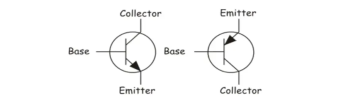

Your board will have some marks with a transistor symbol... Be SURE that your transistors pinout matches.
The one on the left is NPN the other PNP
The board has the transistor symbols. You can match those to the modern BJT data sheets.

I think I may of figured out the problem. There are 3 output transistors on the AWR-094 Board
The original ones on the ends were 2SD313P's and the one in the middle is a 2SB507P
According to what I found on line, doing way too much research than need be is as follows.
The 2sd313P is a NPN trans with a BCE Pinout being replaced with a MJE15032G transistor with a BCE Pinout and so these two are good. The arrow in the circle drawing on the board points to the last leg of the transistor for the Emitter, Right???
The old transistor in the middle was a 2SB507P with a BCE pinout and it is a PNP. It is replaced by a MJE15033G transistor with a BCE also so it should be good, however the drawing on the board (the circle with the arrow) points to the first leg of the transistor which is the Base and not the Emitter. I thought the arrow points to the Emitter only???
So either Pioneer got the schematics drawing on the board wrong or I have the wrong info for the 2SB507P transistor and the MJE15033G is not going to work here.
