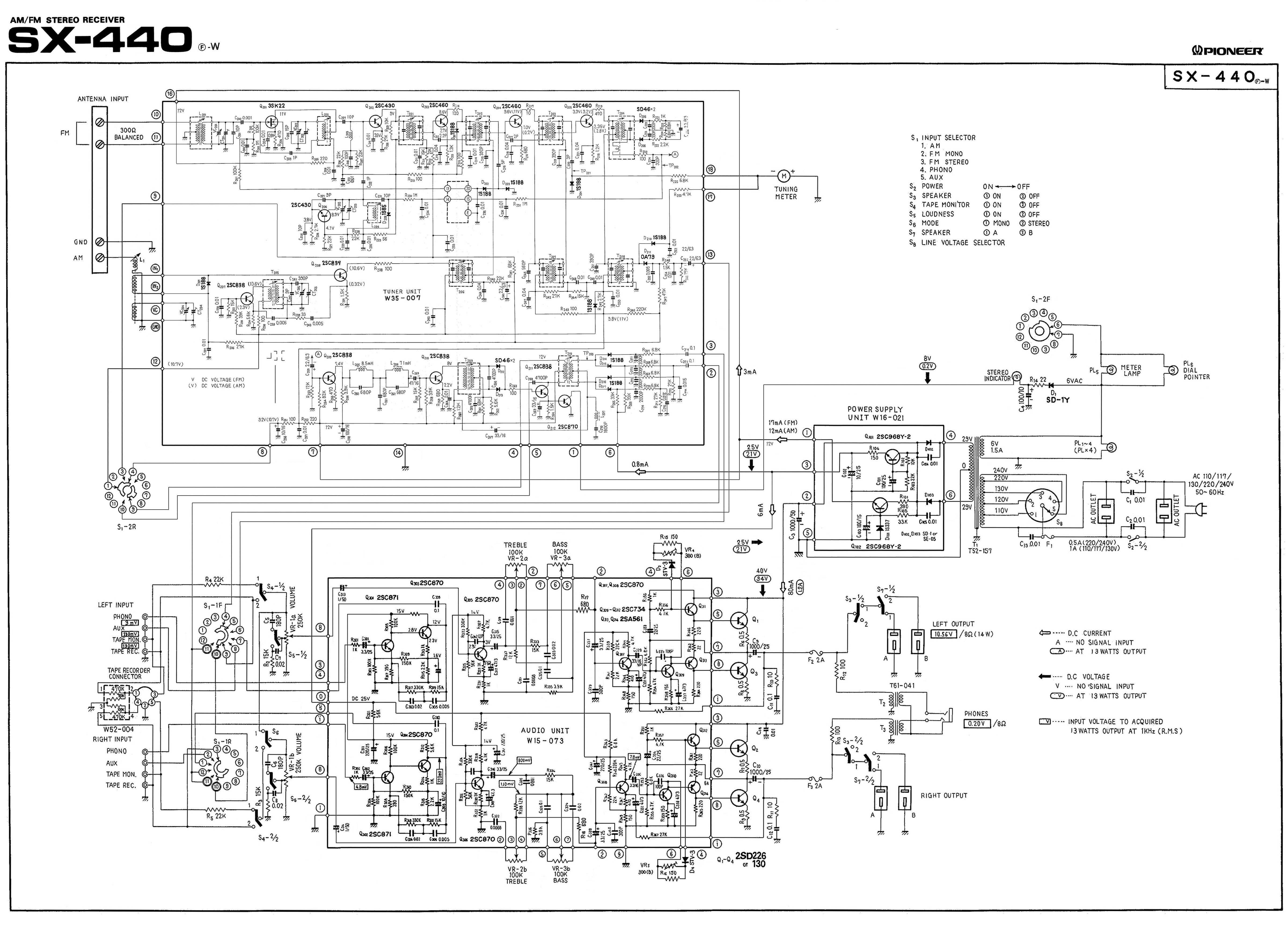

I recapped and upgrade transistors and replace trimmers on the SX-440 I have. The schematic has 80mA to Q1 so I set the new trimmers to 40mV across the emitter resistor . I did 80mA x 0.5 ohms =40mV . The original bias setting were 59mV , 42mV so I went with 40mV for both sides .The SX 440 plays well but seems to be running hot. I have connected to a pair of Sansui SP3500 which are easy drive. Do these SX 440 run hot ? Thanks
That indicates 80mA total from the 40V supply. That would indicate 20mA per device since that supply feed both channels. If the voltage drop measurement is being done on a single ½Ω emitter resistor, with NO speakers connected, the voltage drop should be around 20mV. Is that what you are measuring?
Why don´t you measure with an amperemeter by temporarily using the meter instead of F2 / F3? Each should measure 40 mA. But: Watthour is right.
Some amp designs (output transistors) have a switching threshold and propagation delay requiring that kind of idle current. It's not inordinate, but it does add some heat. To be fully reassured, it might be a good idea to clean the outputs and heat sinks, and refresh the thermal paste for best heat transfer.
Bias set to 20mV . I have another question . I'm getting a slight hum in speakers ,its not effective by the volume control .Is this normal for this design? I can hear the transformer hum also. It plays fine and sound pretty good . Thanks
You recapped it, so I understand the filter cap also is new and of the proper value. I would take a closer look on the rectifier diodes and perhaps the stabilising circuits for the other stages (I don´t have the schematic of the 440 here).
Try increasing the 1000µF main filter by paralleling it with more capacitance to see if that improves the hum (if you already replaced it).
EDIT: schematic for LX440A and not SX440

Bias is calculated by measuring the voltage drop across one of the output transistor emitter resistors (R8 left), then applying Ohm's Law: I = Voltage drop / 0.5Ω. Do this for each channel (R9 right). The current in the power supply feed includes bias for both channels, and steady state current for the rest of the power amp circuit as well.

You cannot just use half of the power supply line current as your bias goal, because there are other current paths in the power amp that it feeds (bias spreader & driver transistor circuit).
You should have your meter leads clipped across the emitter resistor (R8) to measure bias. The 'ground' connection on this schematic is rather ambiguous.
Have you noticed the pin numbers on the power amp PCB (Audio Unit AWK-008) schematic have a dot or two dots above them in their circles? The number itself is used multiple times, and pins differentiated by the dots above it.
I don't see any spec for the bias for the LX-440A or the SX-440. I have suggested 20mA (from AK observations) as a reasonable bias to start, which would be 10mVdc across one 0.5Ω emitter resistor.
