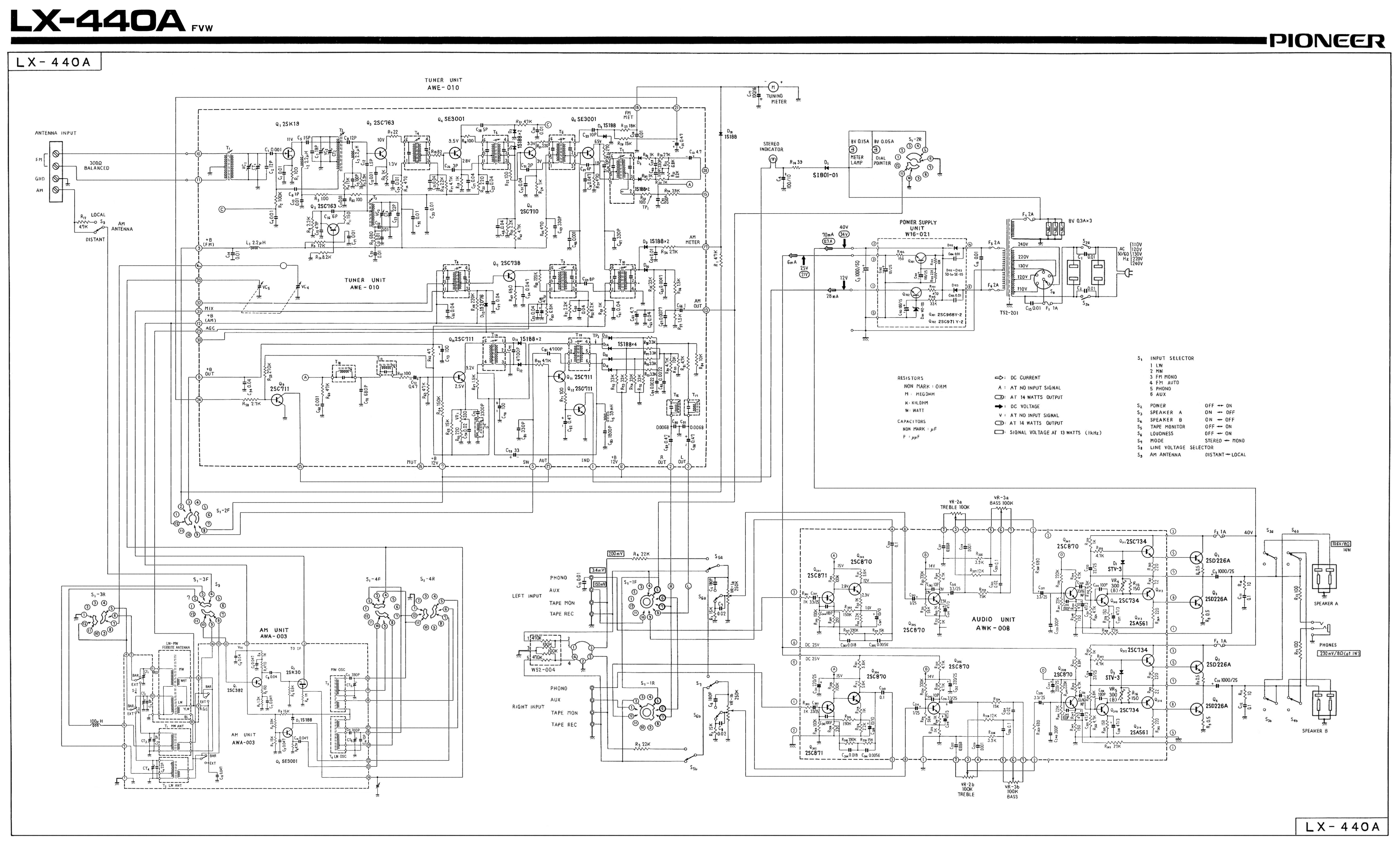

Have you noticed the pin numbers on the power amp PCB (Audio Unit AWK-008) schematic have a dot or two dots above them in their circles? The number itself is used multiple times, and pins differentiated by the dots above it.
I'm sorry, I'm not sure if I understand what I need to check on the schematic. Are you asking to check the number of dot in small circles like this ?
Does adjusting VR4 (for left channel) change the bias voltage across R8?
Yes, the adjusting of VR4 change the bias voltage across R8.
I don't see any spec for the bias for the LX-440A or the SX-440. I have suggested 20mA (from AK observations) as a reasonable bias to start, which would be 10mVdc across one 0.5Ω emitter resistor.
I set the value for R8 and R9 to 10mV. The sound is good from the amp.
