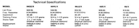

Thanks for the good quality photos. These don't come up very often, but the measurements owners have done puts the 77 family squarely in the category of clones of the 66 family [also called Rex, and of course Rex = royal]. This puts them all the way back to 1973.
In other words, the 77s all use the same 525-to-600 ohm body, exactly as the 66 models do, and as with the 66s, the stylus inserted determines the model. In this case, the 77/X came with the same stylus as the 66/X, a .7 mil conical with a red grip, which Empire called S906. But it will sound exactly like the top 66 model, the 66QE/X, if you can find a purple S912E (as Empire called it), a nice-sounding .2x.7 mil nude elliptical. Sorry to say, the more-advanced styli have become very hard to find, and are priced accordingly, and the generics have historically been disappointing. Still hoping that will change. However, Gary at thevoiceofmusic.com ("tVOM" here on AK, a seller with known-good customer service) still has the S906 for ~$32 shipped. Our collective experience with Empire's conicals has been uniformly good, beyond expectations, but of course they are conicals, with their advantages and disadvantages.
Here's the 66 family lineup, taken from an Empire publication:
