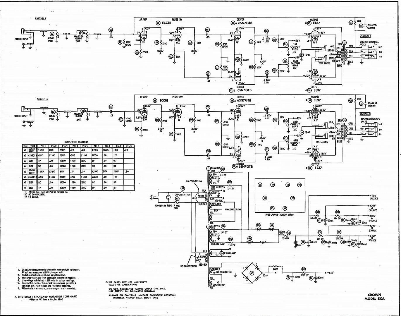

So I got this amp in a trade deal a few weeks ago, and after one issue of basically building it back from scratch, from a blurry schematic from 1960, I still am getting some 120hz hum when the unit is idling, with the inputs shorted. I just replaced the selenium rectifier, and that seemed to help. I had to rebuild the filter cap sections, replace many resistors. I have checked everything, but still audible 120hz hum from this amp. It runs the tubes pretty hot, at 475, and some capacitors are only rated at 450. But I guess what I'm asking is, should I replace the rectifier diodes in this, beings they're from 1959? And they appear to be silicon, or at least look like it. Is that possible in 1959? And could the noise be attributable to the switching noise in the caps? Because although not the neatest wiring I've done, it seems to be correct. With everything within tolerances. I even put two 100uf 400v caps in series to get more reservoir and voltage potential at 50uf, with the schematic calling for 40uf. Still the hum is there, albeit muted. I've searched for noisy output tubes, and preamp tubes, but to no avail. Plus all the tubes are new or NOS, and I've even swapped others in, from working amps to see if that helped. Am I hearing some very old, very used rectifier caps? Everything including the bias supply has been rebuilt. Just wondering if anyone has the experience on this one to suggest if the switching noise would still be audible. I did a little work on the bland cosmetics. Lol. As it had to be the most austere amp I've ever seen. And yes, I disconnected the LED's when hunting the noise down.
Also, as I look at the schematics, it shows two half wave rectifiers, one for each power tyranny. So halfway rectifyers will basically make more noise right? Is there a reason that these are half wave? Or is there a reason I can't go full wave with these? Are these diodes actually the ones they were making in 1959? Are were they replaced later on? And might that be the reason for the noise which seems like switching noise? Basically one answer could probably satisfied this whole series of questions. Thanks for any help!

120hz is power supply, but imbalanced output tubes will do this too. The output tubes pull power very early in the supply so its fairly dirty. It relies on equal current draw on each side of the output transformer to cancel it. If you haven't set the bias on the output tubes yet, do that and see if it shuts up.
Its not half wave, this is a classic full wave grounded center tap config. Exactly the same as it would be with a vacuum rectifier, just with solid state parts.
also if the original HV rectifier was selenium, replacing it with silicon will bump the voltage. I see a resistor between the output of the rectifier and the first cap. You can simply bump that resistor to restore the high voltage to where it belongs. Confirm the heater voltage while you're at it though, all of those B+ numbers will be made with the heater supply at 6.3 vac. Higher line voltage skews it, but incorrect output tube bias skews it too.
if you have 475v on a 450v cap, replace it with at least a 500v cap or its going to puke sooner or later.
Better schematic, and this is the complete Sams
looks like its calling for 490 volts at the first cap, so that needs to be at least a 500v part and I'd prefer 600 since the initial voltage spike before the output tubes heat up is going to be considerable.
I don't know precisely what its expecting for bias at the tubes, but making some assumptions based on the 130ma figure on the power supply, having each tube running around 40ma doesn't seem unreasonable. That would account for 120ma of the total, and 10ma for the remaining tubes isn't too bonkers. Looks like you'd need to plug an ammeter into the test jacks to do that.

Did you change the bias supply's filter caps, too? C3 and C4. Note the reverse polarity on the caps.

I'm going to try some other power tubes now, though I tried that recently. In the last few days I've replaced the bias power supply, with a modern silicon rectifier. To answer the question, yes I replaced the bias supply caps, two of them at opposite sides of the board the original caps were 80uf at 150v, currently I have two 100uf (the same as the schematic, one rated at 350v, the other being a can, that I wrapped with insulation, as is the practice I've usually seem with the cans, that since it's a negative supply, the cans are typically insulated from the chassis). The bias supply seems to be fine now, though I don't think it was originally the problem anyway. I also took 2 full wave bridge rectifiers and hooked them up the way they would be used in this scenario with a center tap as these do.. I basically hooked the summed ac leads (one from each tranny), summed after the 15 ohm 1 watt resistors and connected to the negative terminal of the bridge rectifier. This would give it two instances of two diodes going forward, to the positive terminal (i figured it wouldn't hurt maybe a little less loss, less switching noise and higher rating). I used fast switching modern bridge rectifiers from a very large power amp that I parted out a while back, both rated well over a thousand volts. This made the hum slightly less, BUT still not gone. And since then I've quadrupled the.
Capacitance reservoir, by putting two 100uf 450, caps in series (50uf at 900) and added another on the other side, of two 80 uf clusters of 10uf caps at 450v, in series, so 40uf at 900. The bias supply has test ports, and they connect to these 47 style bayonet bulbs in the front, which light up when the bias is low, or when overdriving the amp, but I'm thinking of removing all of that, as I don't like all of those wires crisscrossing the amp with the potential to pick up noise or worse.
The bias supply according to the schematic should be -55vdc, which it is sitting at comfortably and steadily.
I have noticed that when I put a test probe on one of the bias points after the resistor that on one tube it makes a bit more noise when the probe is used. And it seems to affect the overall hum level. That initially when I grounded the inputs to make sure there was no. R f or hum coming from the inputs, It seemed to make the hum louder!! That seemed like a clue as well. Though i'm not sure what it would be a clue of? I know it's got good power going to it. I put a three prong cord on there, Which I kind of worried about because it wasn't designed with a three prong, But took it upon myself to make the chassis ground and everything in the amp to default to chassis ground now that it is indeed grounded. I have noticed no ground loops from my a c sources, having used many different ones to be sure... When I pull the preamp tubes, a lot of the hum disappears. I'm going to get my scope out and scope. The actual power going to them and in different locations to see if it's still putting out some ripple. One thing I noticed early on is when I wired some of them incorrectly, It made the hum a lot worse... That maybe the current demands of the power section had something to do with the ripple getting through to the preamp. Is that would be the case what would be the solution? Isolating the power supply more? Possibly separate power tyranny for the preamp? I think that maybe it's just a little too much current demand causing the 120 ripple... That if there were a second power supply for the preamp and driver tubes, What I have here is probably exactly perfect for the power tubes, But not necessarily the preamp. How do you or how would you go about? Isolating the preamp power supplies from the current demands of the power tubes?

don't throw huge capacitors at it. this wouldn't have hummed excessively with the original value parts, and putting huge ones in there is going to torture the transformer with high peak currents.
also the high voltage supply does not use bridge rectifiers. You need individual diodes for this. If you're aiming for overkill, a total of four 1kv 1 amp parts (1N4007) is all it needs.

Just to clarify, I used single diodes, basically, by picking the place to put the wires in the bridge. And I wasn't aware of the center taps when I first wrote this, hence my dumb comment that it was half wave. I'm not super experienced in classic tube rectification, but I'm learning. After I wrote that it seemed crazy to me that with the really nice components that they would have opted for half wave. They only full wave rectifiers. I knew of used just the two ac leads and no center tap.... I took a refresher course online here and figured out that it is indeed full wave. So... Re-learning, learning... lol. After that I had the single diodes, but looking at the schematic, it seemed just as prudent to leave the bridges in and just tap them as two diodes in series... I guess what i'm curious about now is why they use Two in series, Or three originally, as opposed to the schematic. Was that because the diodes were not highly rated enough back then? I'm thinking I can get by with just one where they had 3 in series before? Meaning less voltage drop and potentially less noise ( I have nothing in my knowledge base that tells me maybe less noise, this is just hoping).

Don't measure the grid voltage, it doesn't matter. measure the current flow through the tubes. Thats what I mean about equal. Go for 30ma at the test points. Going to need to make an adapter to fit the plug, or just eliminate the test points and put in 10 ohm resistors. Set for 300mv across the resistor on each tube.
