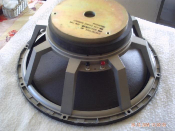

The big woofer has 321 stamped on it, I thought it could have been a manuf EIA code but 321 is Triplett. They make meters but not speaker drivers. So that's out. There's another number there in the top line but it's more than 3 digits and starts with F, so probably a Frazier part number or something else, not a manuf code.
I'm going to guess the two woofers, being different, are crossed over at different points, so the big one is working a bit deeper than the other one. This is sometimes done on speakers with more than one woofer. A schematic would make it more clear.

EV doesn't seem to have an EIA code. Of course not everyone did, I just never tried to look them up before. I don't know EV drivers very well but I've certainly seen plenty of square magnet CTS's and I would agree on that one for sure.
Compare this photo to yours. Looks like a match. Three holes in the magnet, hole between the wire lugs, same casting in the frame.
EVM15L:
EV was 649 in 1961. Those usually didn't change, though changes in ownership might have had an impact.
