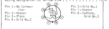

First thing you want to do is get print outs of the tube data sheets' pin out illustrations so you can look at the pins from the solder side because the schematic doesn't number the pins.
