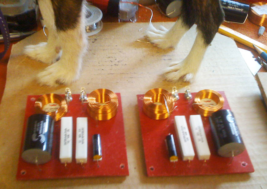

Completed the notch filters for the JBL OASR waveguide AR4's yesterday. Francis was there to lend a bark of encouragement.
Thanks again Zilch for the ongoing lessons in speaker building.
Very nice. Please share info. Is that a pre made crossover from Parts Express?
Wired guy built those from scratch. They are supplemental curve-shaping filters for the EconoWave crossovers in his AR4x upgrade project.... :yes:
