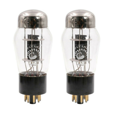

a bit more expensive but you may want to try the new PSVANE series or shuguang nature sound series. The shuguang WE series was the best sounding 6SN7 I have heard.

About 3 weeks ago I purchased a Schiit Freya+ and rolled in these set of tubes and so far they sound amazing in my specific system. Not anywhere near burned-in only 20 hours and noticed last night the set broke the initial threshold and “bloom” came alive out of nowhere; great experience. I highly recommend….Plus the tubes themselves have a great construction aesthetic to them; they pair well in the Freya+
. Psvane 6SN7-SE (Silver Globe)
. Psvane Treasure C181-Z

I do not care for Psvane tubes, any of them... I have spent considerable amount of money on buying their tubes, including the 6SN7-UK, CV181-T MKII, 6SN7-T 3 ART and the CV181-Z Treasures. Their higher priced tubes comes with "certificates" which show their "tested" values. The first red flag was that the four 6SN7-T3 ART tubes I bought were ALL certified with the exact same current and voltage value on each tube. There is no way that can ever happen. And sure enough, when I tested the tubes, the gain measure varied from 18-20 (the accompanying 6SL7-T3 were "certified" to measure 90 mA but measured only 60 mA on one triode and 74 mA on the second triode, nowhere close to their "matched" 90 mA claims). Amazon had to pull the Psvane Horizon 6SN7 tubes off the market because a lot of then were being returned because of noise and microphonics. Psvane advertises that all the Horizon tubes are tested for 24 hours before being packaged and sold. If that was true, how did all these defective tubes reach the market? It's another of Psvane's bull being fed to the market.

Thanks so much Jon for the detailed response and your experience with the new production tubes. I’m pretty new to the tube game and had no clue that these Psvane’s that me and people purchase are not even within spec when you purchase and pay good money for. The 2 sets of Psvane tubes I purchased all came with the certificates and spec numbers but who really knows if it’s fabricated or not. I did purchase some matched NOS sets as well but haven’t tried them yet since I just got my Freya+ like 3 weeks ago. These are NOS tubes that I picked up
