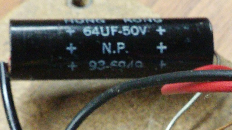

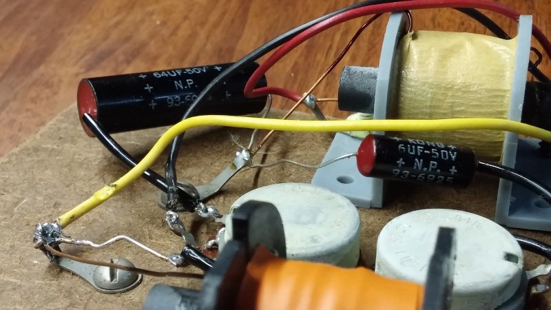

Crossover.. Looks like the caps are from Hong Kong.. Is it possible these are not originals and have been changed? Values are 64uf @50V and 6uf @50V.
From the other threads I've read, these values seem off, but I'll have to go back and re-read.

I just opened up a pair of W60D Mark II an hour ago and have the same observations and questions as you. Now that we both have identical speakers, we can confirm originality.
Your's and my caps are likely original because they match in description.

It looks like a recap would be the first order of business. I know nothing about capacitors, but I can solder. Google tells me that I should hold out for oil caps like the GE Dielektrol, but maybe I'm barking up the wrong tree here.
The original caps are non-polarized Minerva 64uF-50v. And there are what appear to be smaller caps as well: Minerva 6uF-50v.
Are these electrolytic caps?
Should I simply seek out equivalent replacements from Parts Express or the like, or should I attempt to improve them by hunting down some oil -filled caps?

I did see from a google search for 'minerva hong kong capacitor' that someone else asked the same question, so the capacitor values are correct, 6uf and 64uf.
Also, seems that folks have recommended Dayton capacitors and got good results. Ordering these now.

Sounds like you already have the caps on order, good deal. You can hook up both cabinets and run them, see if all the drivers are working. The tweeter and midrange may sound weak or off, but that could be due to the very old and creaky polypropylene capacitors. They were very inexpensive when new and probably didn't stay within spec for very many years, if they were within spec when new.
Leave the surrounds alone, that's how they were from the factory.

As far as the caps go, for those speakers it matter more that you're replacing them versus what brand or model number. Dayton, Erse or Solen, your ears won't hear the difference. Go with polypropylene or metalized film, just flip a coin. I'm a huge fan of what Madisound has to offer, their speed of delivery and selection of goodies. But that's just a preference, nothing more.

Something seems a little off here, lol. I know these are 400V instead of 50V, but the 64uf cap is bigger than a D-cell battery whereas the original is just a little more than half the size of an AA. (new cap looks smaller in the photo because of the angle)
Seems like a ridiculous size for a crossover cap. These should sound really, really good.. lol.
What do you folks think.. Should be OK? Will this extra large size present any problems? I plan to double stick foam tape or zip tie it to the board if that makes sense to do.

Sam, I came across a thread where the poster had found some NOS GE oil filled motor start caps. They were big as well. He glued then to the board. I'll try to find the thread and forward to you.
EDIT- here it is: http://www.audiokarma.org/forums/showthread.php?t=602425&page=3

Hahahahhaha, yeah! They huge, huh? As the voltage rating goes, so does the size. I wish I could get the same brand cap at 200v, sure would make it nicer for mounting in the cabinet. All good, time to get to gettin'!
I recently recapped a pair of Leak 2060's. Very similar to what you're working on, just more refined and newer. Notice the Wharfedale tweeter, and I had a 75uF cap in there to mess with. It was so large I had to run wires away from the crossover board and mount it on the back of the cabinet.
