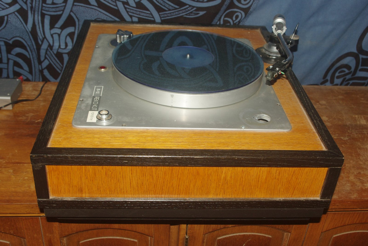

I removed the Black Widow and Grado wooden tonearms from my B-12 and added a Denon DA-50 on the back of the plinth. Because of how awkward it is to reach the cuing lever on hte back of the plinth, I turned it 90 degrees so the side is now the front. I put a Grado XF1 in the tonearm and now have the best sound I've ever had from any source in my system.
