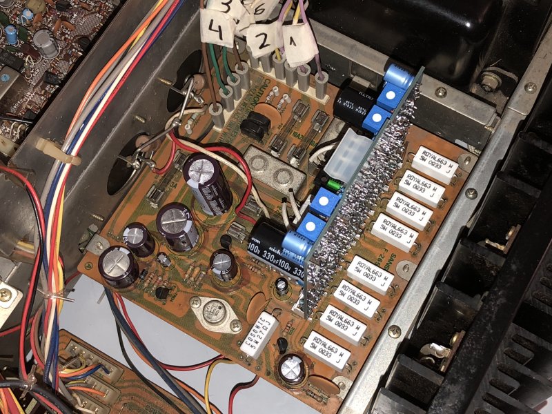

Hi guys. I'm about to begin with the restoration of my uncle's old Sansui 9090DB. The receiver is in a pretty bad condition, it has been serviced by bad technicians and they replaced parts with cheaper or wrong ones.
Issues:
. Burnt resistors
. Blown fuses
. Blown outputs
. Scratchy pots
A few months ago I decided to start with the restoration myself as there are no good technicians where I live and trying to get quality parts it's almost impossible.
I decided to do the following:

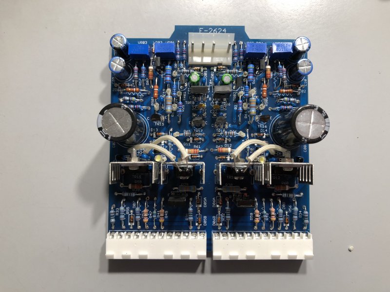

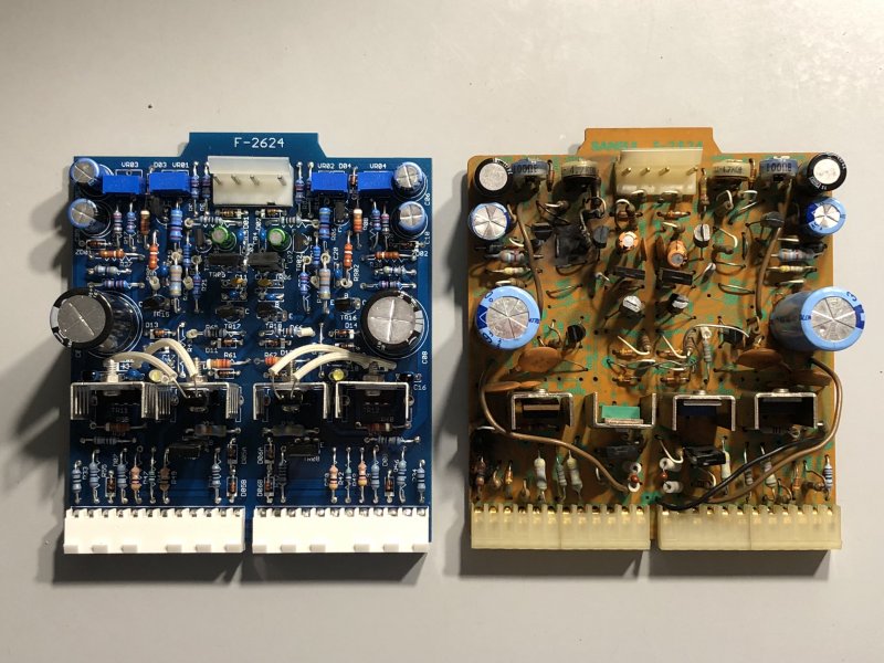

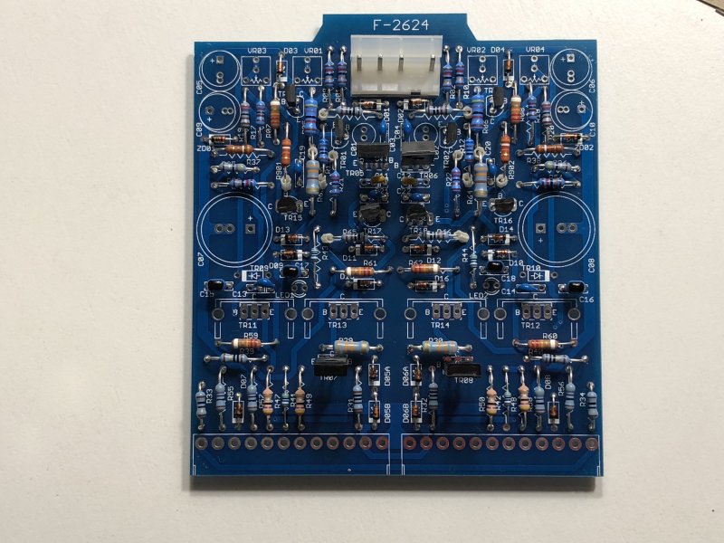

. Rebuild from scratch F2624 Driver board
. Replace capacitors and resistors from F2656 Power supply
. New fuses
. New outputs
. Clean all pots

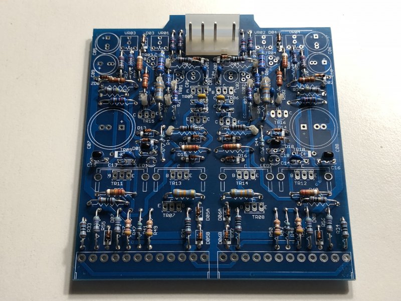

Because I'm not an expert in electronics I thought it would be easier for me to start with a new F2624 instead of troubleshooting the whole board. So I got the new F2624 PCB and most of the other parts from mouser and digikey.
Also built myself a DBT cause I don't wanna blow everything up on the first run but I don't know yet what type of bulb I need to use for the thing to protect the amp, I got a 70W but don't know if it is the right wattage. I'm on a 220v area. Any suggestions??
What most scares me is when time comes to adjust the DC and Bias current, I know it is a very fragile thing and needs to be done correctly.
I would really appreciate it if someone can give me any tips, tricks, suggestions so I can make this restoration right.
THanks!!!
Here are some pics of the amp before I begin. I will be posting updates on my progress.

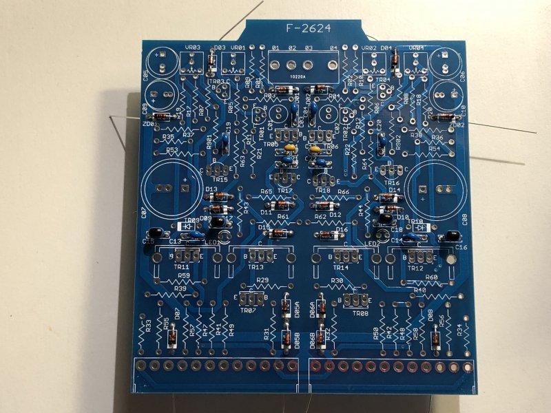

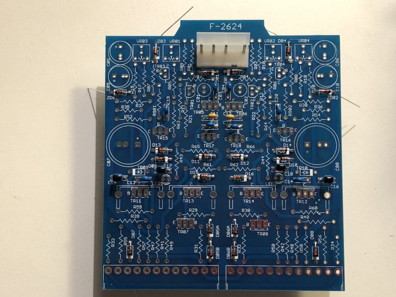

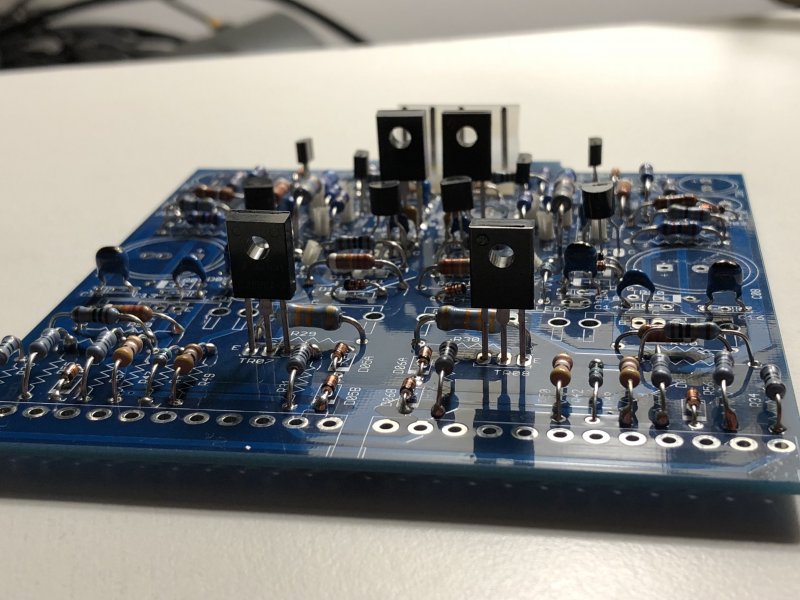

Following Tom's assembly guide:
1. Ceramic Capacitors
2. Diodes
3. Molex
4. All resistors
5. Low power transistors

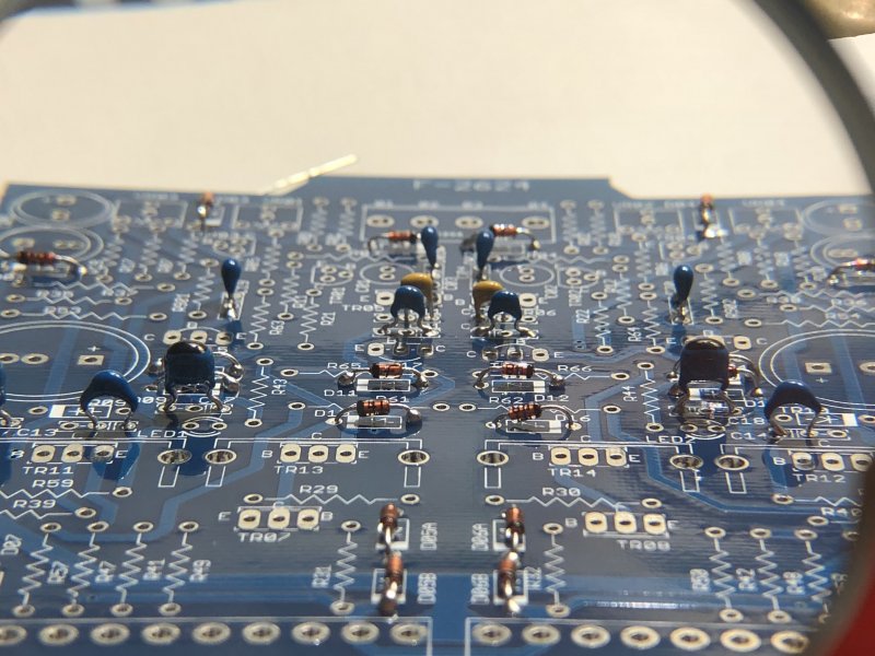

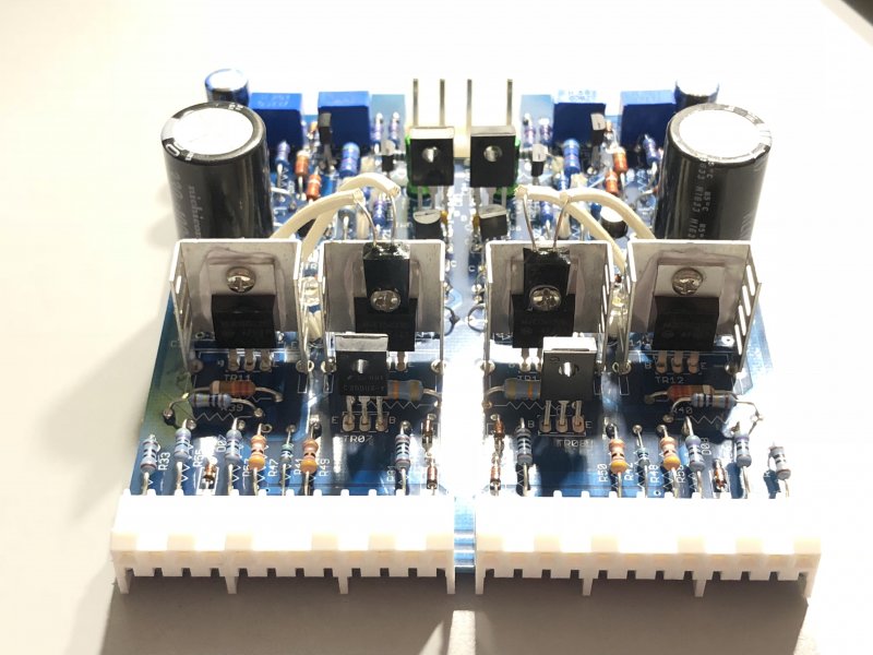

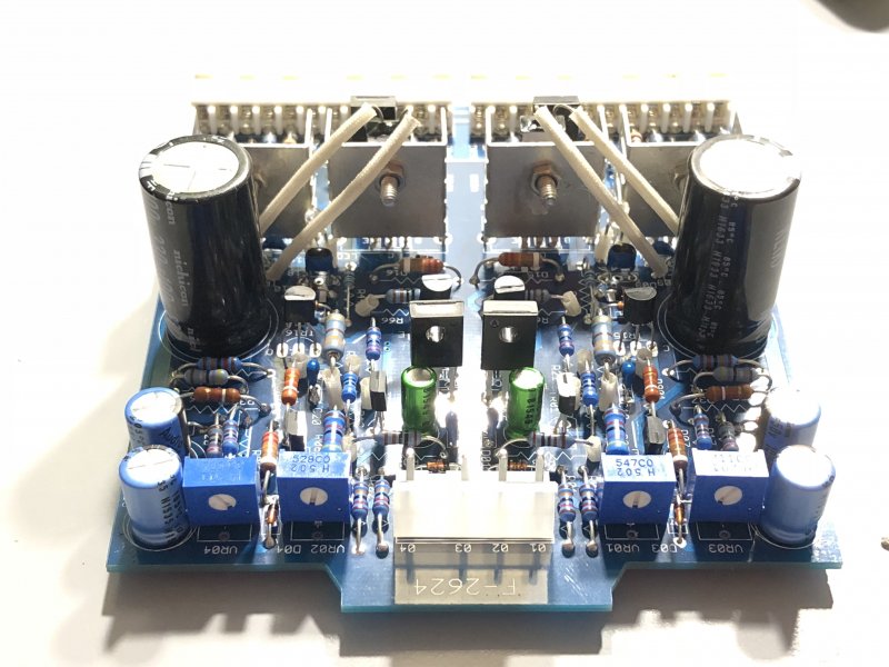

Looks nice! I'd wrap some shrink around the STV-3HY leads or make sure the systoflex goes all the way up, so it doesn't short with the heat sinks by accident.

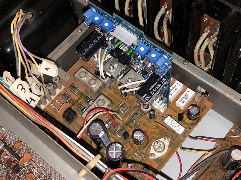

I'm trying to bias the amp but the green light doesn't come up...It stays on blinking red. The DBT bulb turns on but immediately starts dimming...Could it be that the 70w bulb DBT doesn't let the amp power up correctly??? without the green light I still can read 2mA on the bias
Unit has been off for years...Maybe old capacitors need time to charge on DBT??
Here a video:
That's expected while the main filter caps are charging. If the protector circuit "protects", it prevents DC from getting to the speakers. Most likely you got too much DC. While the red led is flashing, you can measure it for each channel on the gray and blue wires (each against chassis) coming out the bottom of the PS board. This will indicate if you got a DC issue.
Should I measure these blue and gray wires with F04 and F05 fuses in the circuit?
yes, good, keep the black probe on the chassis. you can get negative reading. How much?
I got around -200mv on both channels...Took it down almost to 0mv...But still i can't get the green light...
Gonna try if it goes out of protection without the driver board connected...If it goes green I should assume that something is wrong in the F2624?
