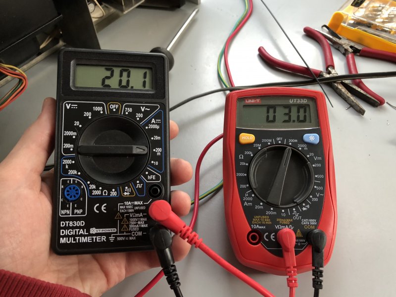

Way I do it is to measure/set the offset and bias at the same time. Now you've got two meters you can do this. Focus on one channel at a time leaving out the fuse of the other channel. See if your adjustments are working correctly then do the same thing on the other channel; this way you will be able to identify which channel is causing the issue. It may be you have excessive bias and the current limit is getting in the way. I always use a 60W DBT at this stage and use about 15mA to 20mA for the bias...
The buzz is rattle from the transformer. It's a tradeoff of working wit DBT. It will go away on mains. The DC measurements look OK for both channels. It starts high, gets filtered out, and fluctuates +/-3mV.

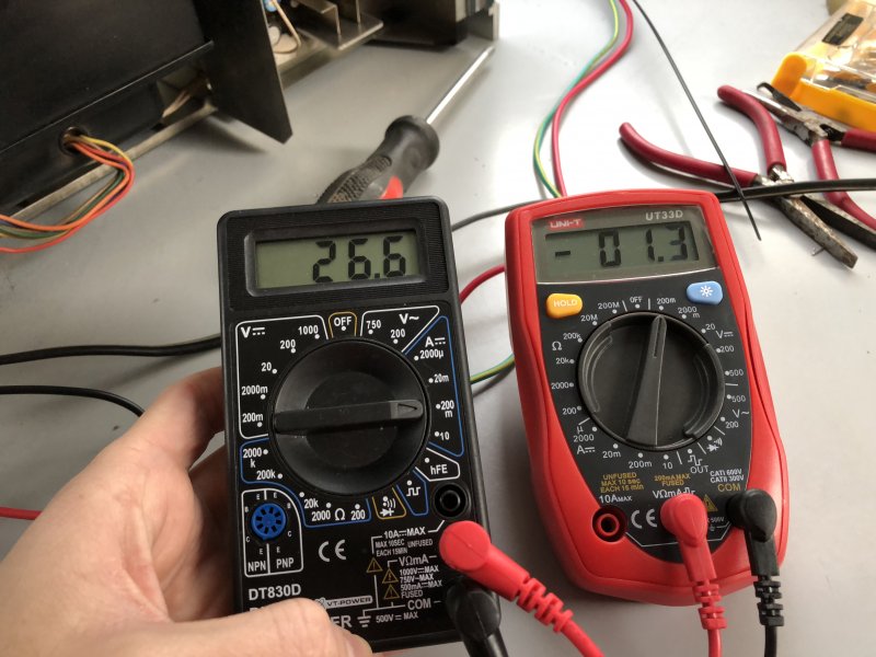

I tried Doug advice and these are the readings:
Right Channel:
Left Channel:
There's no DC offset...So why the protection circuit still kicks in??? Should I give a try without DBT??
No, not yet. By all accounts you should have a green light with these settings. I don't think it's a driver amp issue. Likely a protection board problem or a flaky trace/solder pad/jumper issue on the power supply board. Are you sure the buzz is emitted off the protection board? I really think you should overhaul it.

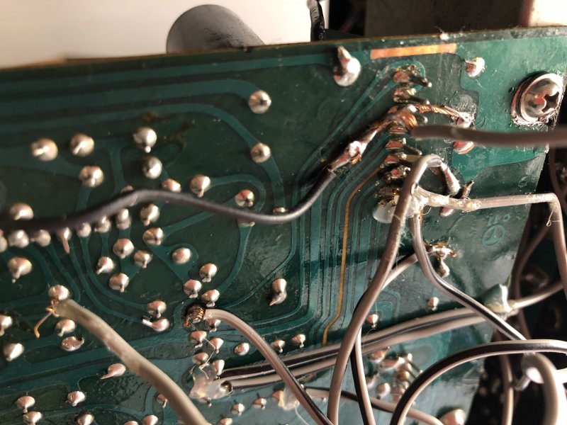

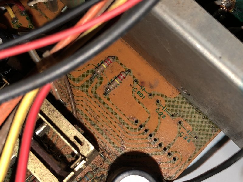

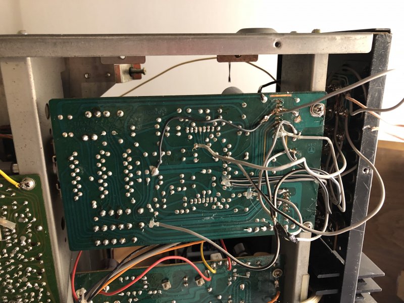

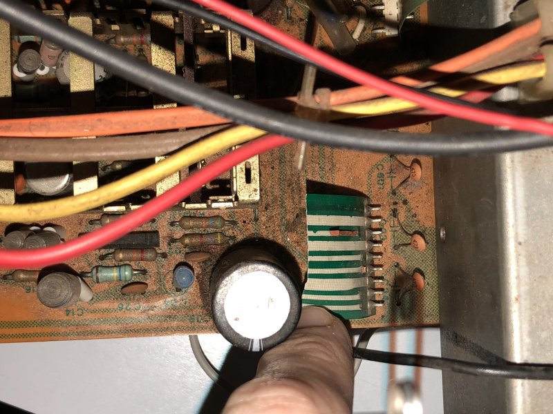

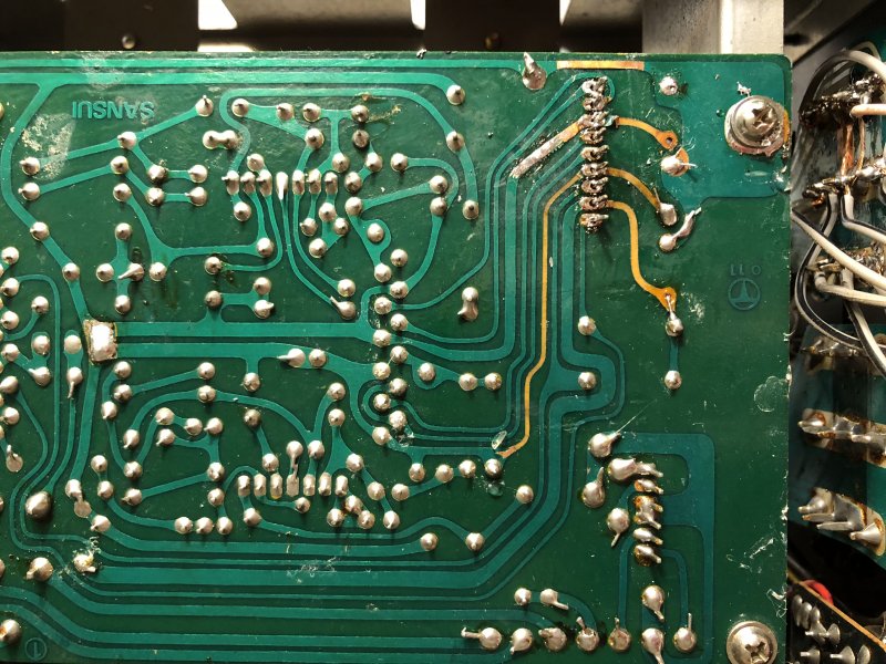

While making the list for the next recap there's another issue with my amp.
Check out the actual condition of my F-2653 equalizer board...:(
For what I know, the traces started to peel from the flex and touched the chassis...that created a short that burned those three capacitors. I think that short also affected the driver board.
I still don't know how those traces on the board disappeared.

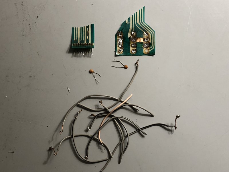

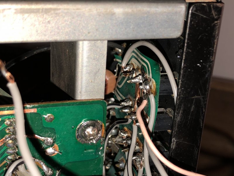

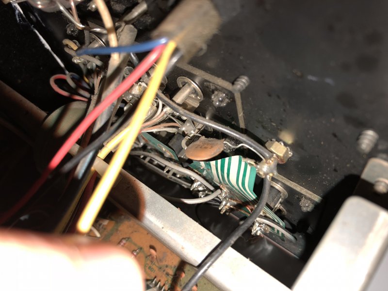

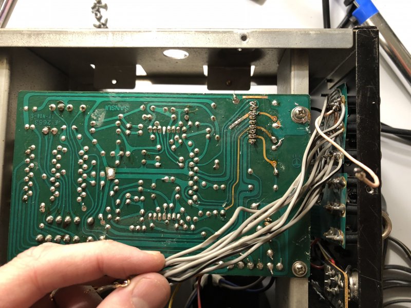

An unknown technician did this mess with the inputs on the back and the gray cables trying to "fix" the issue..:wtf:
I'll try to get a good 9-pin and 6-pin ribbon cables to replace those and reconstruct the traces
