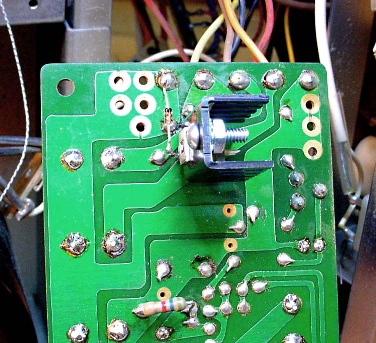

Just to confirm ... to add the regulator, you're cutting the trace to Pin 01? Can't quite make it out on the super closeup you posted - nice pic, but no point of reference that works for me.
I finally got around to resurrecting my resurrection here. Got all the boards that hide behind the front panel and figure to put that all back together and test the results prior to tackling the rest.
Also, which leg of the regulator goes to which side of the trace? Seems to me, output should go towards the pin ...
You know, I don't remember the exact placement, but I will open it up and get better info for you.

On the regulator thing, I was hoping you had a link back to Jim's stuff or a bigger pic - appreciate your offer to dig deeper on that. On the plus side, that should be visible with a quick pop of the top ... :yes:
I took some more pics, in the pic pin 1 is at the top, diode is connected to pin 2 and pin 3 is on the bottom.. I cut the trace between pin 1 & 3, kind of looks like a scratch in the pic

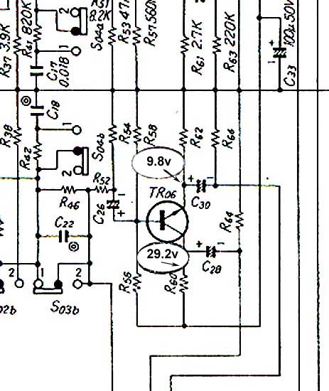

While we're at it ... the infamous C30 on the volume board ... this one's right, which makes it wrong. Er .. Right? Seriously ... I'm confused here.
Yeah, I had to carefully look at the schematic and compare it to the board, I will have to check my other pics when I get home from work today.

OK ... did some digging ...
- Schematic excerpt
- Board layout from manual
- Actual trace on my machine
Which all seem to follow.
C30+ to R62 and TR06 emitter. Unless I'm going cross eyed here, that matches the actual board markings.
I guess what TRNSFMR is saying is they're ALL wrong?

I went through my emails with Jim and found this "C30 is in right and wrong on various units. AND the board comes with the solder mask labeled right and wrong."
In mine, the mask was correct, and it was installed correctly. And it seems that way in yours as well.

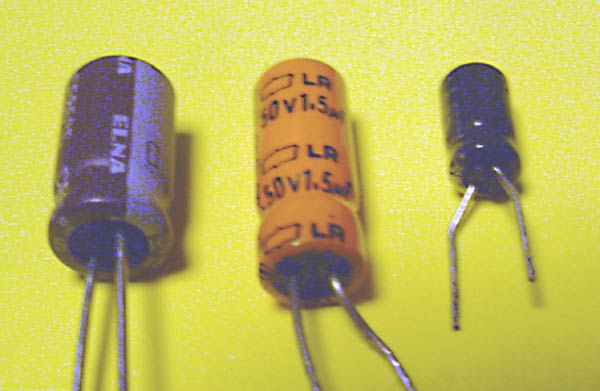

I'm curious about the caps in your pic of C30, were those the old ones? Or the new ones?
So we can trust the schematic anyway. Good to know. I'll mark that board as done ... again.
The pic shows the new Panasonic 1.5uf 50v caps ... tiny little things compared to the originals. I went with Elna Silmic II wherever I could, but some values were just not to be found. Went through two different suppliers to get what I got. The Elna caps can be quite large.
Good example for size comparison ...
The Elna on the left is a 1uf 50v - with larger values, it's a good idea to double check the can size before ordering. The one on the right is the new Panasonic 1.5uf 50v. The orange one in the center is the original Panasonic - looks like yours had Elna caps to start with. Must have got a deal on those when yours was built? When did yours leave the factory again? Third digit of your serial number is the year ...

The way I read it is you should get 9.8v at the positive side of C30 if it's installed correctly and X2 power is engaged? I took the liberty of redoing the black blobs on the schematic I posted earlier showing the correct test voltages. I could just make those out on my printout.
Here's the part that confuses me ...
I had a customer who's unit developed a giant pop when switching to 2X. And then a unit on the bench that we had just recapped, did the same thing. I had to use the scope, pour over the schematics and actually think, to figure it out. Turns out that a cap that feeds the relay that switches to 2X mode has the cap marked backwards on the board. This cap only comes into play in 2X mode, but passes audio to the right channel, and is reverse biased by 8v (installed backwards). It's a 50v cap, and I guess most caps could handle the reverse bias. We just got a new bag of 2.2uf @50v caps in, and I guess they couldn't handle the reverse bias.
2.2uf? Huh? What?? Mine are all 1.5uf ... what are yours? Did I have a brainfart on mine and just assume all six of the caps in that section of the board were all 1.5uf? The schematic unfortunately doesn't list all the values ...
Got sidetracked by good weather, but rain today, so good time to head for the shop ... got the 25v regulator mod done ... and hopefully done right ...
Mine turned out a bit different - tucked the regulator in tighter to the board and using a different attachment point for the diode as things got a bit tight. Different heat sink too I think ... I'm sure somebody will head me off at the pass if I made any misteaks ... <G>

One potential point of confusion for anyone following along ... the LM7824 is a 24 volt package. The 25v regulator mod requires changing out a 180Ω cement resistor for a 100Ω to "fudge" the output ...
That's the center resistor. Where it gets confusing is the labeling on the original parts. You can see the remaining 180Ω is labeled 180ΩK - not to be confused with a 180KΩ ... I did check the schematic, and it DOES call for 180Ω ... not sure what the labeling is all about - maybe just to keep us on our toes and make sure we're paying attention. :D
EDIT >> Found out the "K" in "180ΩK" denotes ±10% tolerance. The replacement I used has a "J" marking, which makes it ±5%.
One thing I did notice is some heat discoloration on the old parts. I used a 5W replacement for the center resistor - might as well replace the remaining 180Ω with a 5 watter also ... just happen to have one laying about.
