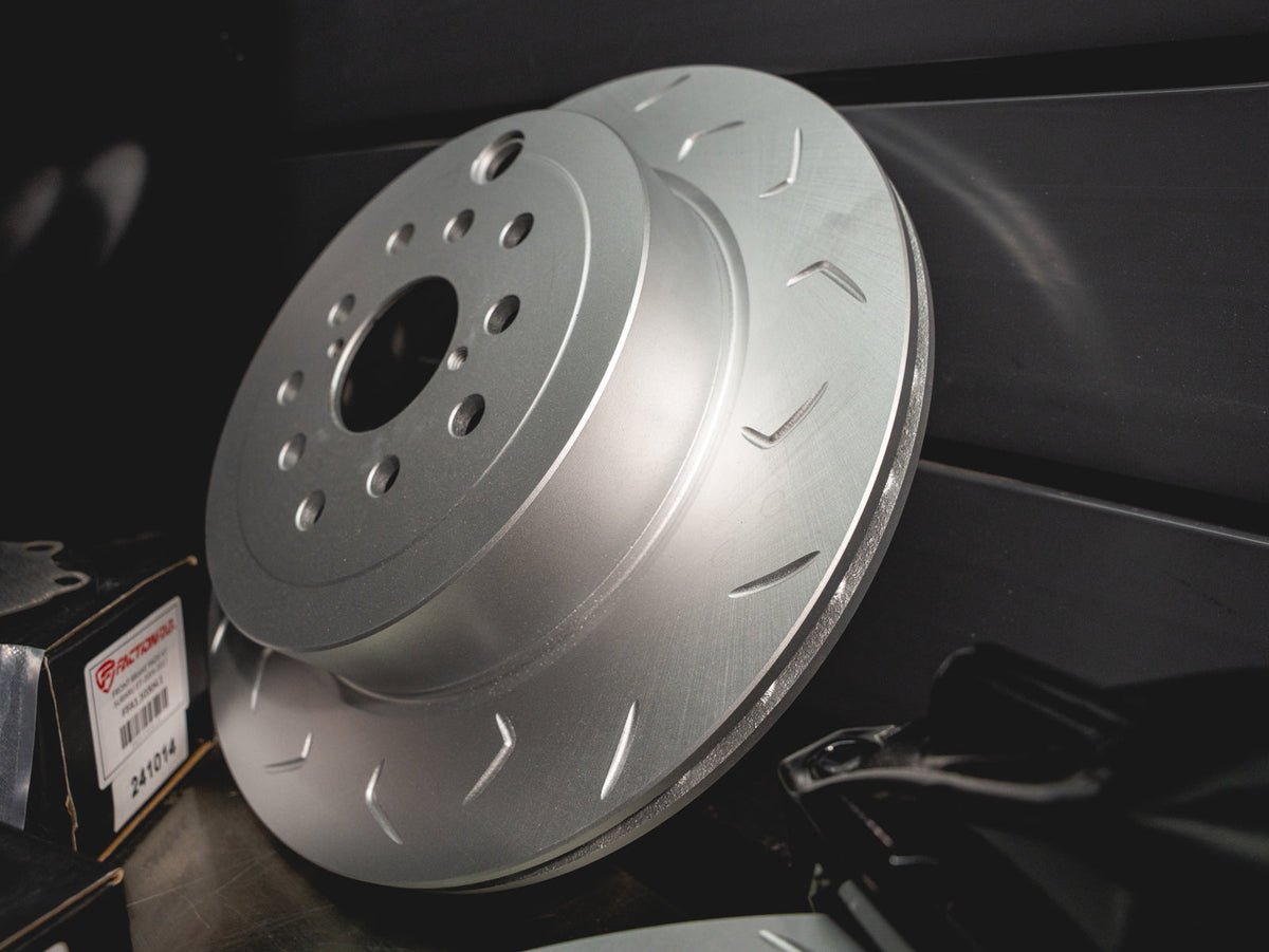

Rotor damage.
Mr Boochie
AK Subscriber
Subscriber
Aftermarket part. :(
Looks pretty thin with lots of scoring, at least from that view. More to the story, perhaps.
I asked him if the brakes showed signs of overheating. Or if he had used them excessively (racing or long downhill runs).
He told me that this happened just after starting off in the morning. Of course, the metal fatigue could have started long before the failure. Like during manufacturing.
He told me that this happened just after starting off in the morning. Of course, the metal fatigue could have started long before the failure. Like during the manufacturing.
Maybe, or not.
Everybody always blames the parts and/or the manufacturer but a broken part doesn't inherently mean it's a part quality issue from a materials or manufacturing standpoint. Correlation vs causation.
Ever watched those "Customer states..." YouTube videos?
Personally, it looks to me like the pads for that brake may have been gone some time ago, and he didn't notice the grinding until the big clank. Looks like lots of crazing too, often a sign of overheating.
Your friend has been driving with no pads on those rotors for a long time IDK how could he not hear the metal on metal grind/squeal. That rotor suffered from massive overheating, hence the crack in the outer part of the rotor where that pad runs. The crack in the hat portion likely happened when they tried to get that rusted piece of junk off the car.
