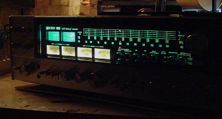

LED conversions can be pretty awesome if done right, but I've seen a lot that are the wrong color and output and just kinda scram at ya. Also annoying if you get flicker, especially for late night listening in a darkened room.
This one worked out just about perfect using 12v automotive retrofit high output warm white bulbs driven by the Sansui's original 7vac supply and a rectifier circuit to convert the AC to DC and eliminate flicker. The light color and intensity are next best thing to a perfect match for the original lighting.
