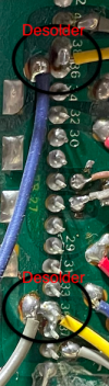

1.)Rear of the board. Remove Jumpers between points (which is really just a solder joint)

F-2547 to F-2546 Modification were not documented. If anyone has pictures of this work please do share.
