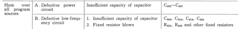

The AU-777 has no protection circuit, so I'm unclear what you mean by "protector bulb."
Assume you have the service manual. The hum on all sources is a fault mentioned in the SM on page 7:
