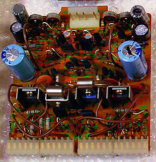

It's VERY likely that the fusible resistors in the output driver boards have gone way out of spec and the amps have DC voltage offsets that are causing the protection relay to trip. As the saying goes, "They all do that."
See Jim's excellent assessment process and repair information here. He can sell you kits of the fusible resistors you will need. Clean the controls and replace those resistors first, then see how it works.
If it doesn't work after that, it's probably going to need some serious work. These are tough to work on so you might want to contact Jim at QRX Restore and send it off to him for restoration if you're not an experienced hand with this kind of thing. If you are, have fun with it. There are plenty of threads here on AK that will help you.

The fusible resistors are meant to be sacrificial to protect some of the more sensitive bits. You should be able to see if one or more of them is bad. Easy enough to spot because they're mounted high on the board because they do get hot. They're located on the F2624 boards - there's two of those mounted vertically in pin connectors towards the back center of the chassis.

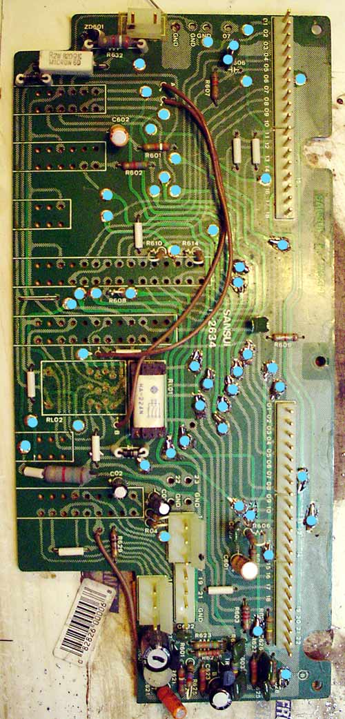

Thanks guys. I will replace the fuse resistors, re-pin the double sided board and see how she comes up. Once shes working i will recap her. Let you know how i go.
I will contact Jim at QRXrestorations too.
Re-pin? As in, already pinned? <G>
Don't take any shortcuts there - it's not something you'd want to do more than once. Desolder each pass through, scrape back the circuit traces both sides, solder a pin in the hole, fold that over tight to each trace and solder, then flow the (w)hole thing one more time to make it purty.
As one who's been there, done that, it's more like ... yikes! NEVER AGAIN!!
(We should start a club or something ... maybe use :yikes: for a logo ... )
You'll also need to remove all the switches and relay to get at all the pass throughs. 51 total if I remember right.
(Don't forget the one hiding under the gumdrop!)

Easiest way to test that would be to swap the boards ... they're identical, and you'll know immediately if the problem follows the board.
Next step up would be to do the bias check and set ... easy enough to do and no fancy tools required.
Don't forget to cycle the mode buttons while listening at low levels and see if that channel pops back in. You can try putting a bit of pressure on the dolby board while doing so - a bit of a bow can temporarily close any open connections and help point towards the problem. Here's what I found in mine when I first cracked it open ... at that point, all I'd done is remove the vertical daughter cards to get a better peek inside.
That's an old chassis foot jammed in there to do just what I described ... so I know it works ... kinda sorta. Couldn't even see it with the daughter cards in the slots. That foot probably worked long enough to get the beast out of the shop and cost a former owner a couple hundred bucks. <G>
* I'd definitely try to get it working before recapping, then do that one board at a time with a hot retest at each stage. Not always possible - I did all the boards that had to be done with the faceplate off, then tested once I got to the point where the rest of the boards could be accessed with the chassis back together. Too complex a box to just rip into it and hope for the best, and every little bit helps.

For anyone who does remove the board completely, DO pay attention to the black wires. They're NOT common ground and hooking them up bass ackwards can make things real interesting ...

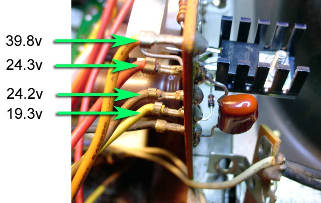

Step one ... check all your fuses. There's quite a few inside on the main power board. Hard to see the element on some of the low amp ones, so a flashlight and a pencil to give em a tonk and see if you can spot anything vibrating works.
Find a blown fuse, time to track down WHY it blew. You'll also want to get hold of a schematic and service manual for tracking back to find the source of the problem.
DO perform a complete visual inspection looking for crispy components, bulging caps ... the usual suspects ... before going any further, and if you do find a bad fuse, at least you know (at this point) that the problem is more or less protected. No promises there ... I'd say you're at the point now that you could end up with some serious damage if you're not careful.
Possible you're having problems with the power supply. Check the voltages on the F2639 pre-power board ... that's the vertical board a bit to the right of the tone controls and provides critical voltage for the drivers ...
Probably worth repeating - the bias controls are REAL sensitive. Doesn't take much of a turn to get out of range and into dangerous territory. Don't want to blow any of those rare IC chips, doncha know.

Measured the leads running to F-2639 and got zero AC volts. Theres a Sanyo transistor which had dry joins so i desoldered and resoldered the pins. Checked the board, touched a few up and still nothing. Just want to let you know that the chassis is live and if i put one of my multimeter probes on the chassis it measures 7 - 10vac. I was pushing down on F-2638 and went back to measure F-2639 and the voltages came up all measured good. Chassis wasn't live as well. Turned the amp off to have alook under F-2638 board to see if any dry joins but couldnt find any. Turned amp back on no voltages.
